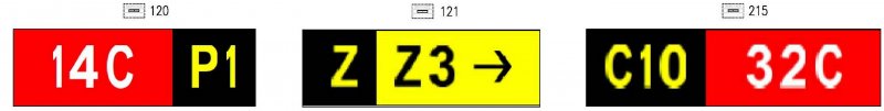

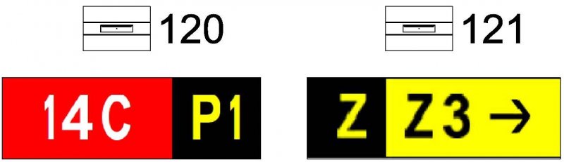

Say...we have an attribute block that show signage post, with it's name & it's signage layout...by using the same attribute block we need to change it's name & at the same time we want to change it's signage layout image.
So by that we will have 2 attribute block (same attribute block name) but shows different description name & layout. For example like this:
How about a Dynamic Block with visibility states?
I was thinking the same way.....but when we are dealing with hundreds of signages (it's an airport signages actually), then the dynamic block will be quite heavy...
