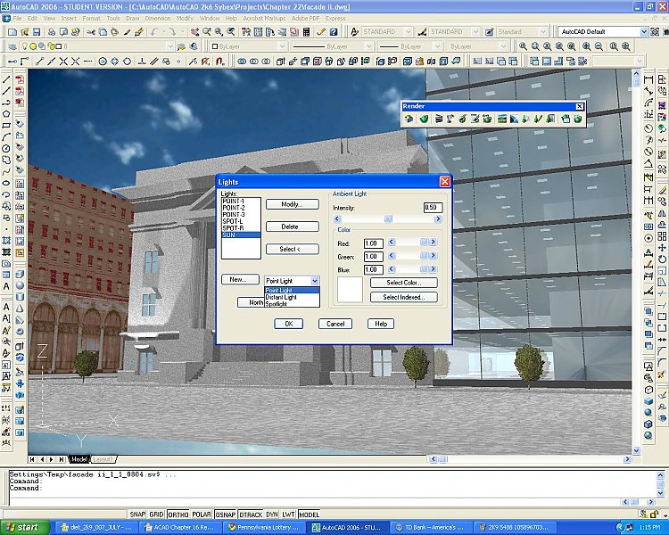

BIGMIKE09281946 Posted July 22, 2009 Posted July 22, 2009 Which of the following is not a valid type of light you can add to a drawing for the RENDER command? a: point, b: spot, c: distant, d: ambient, e: none of the above (i.e. all are valid) I answered d, and was wrong. My argument is: D: ambient is a default light, and cannot be assigned to a drawing Quote
Cad64 Posted July 22, 2009 Posted July 22, 2009 First of all, the question doesn't make sense. You can't add any lights through the use of the Render command. The Render command initiates Rendering. So maybe it's a trick question? Did they tell you what the correct answer was? If they're claiming that Ambient light is a standard Autocad light type, ask them to show you where and how you would add an ambient light to the drawing. Quote

Cad64 Posted July 23, 2009 Posted July 23, 2009 I still think the question doesn't make sense, and it should either be re-worded or thrown out completely, but check this link for information about ambient light in Autocad: http://www.caddigest.com/subjects/AutoCAD/tutorials/select/070604_parsai_ambient.htm And how is it that the correct answer is B? How can they say that the spot light is not a valid type of light? Quote
