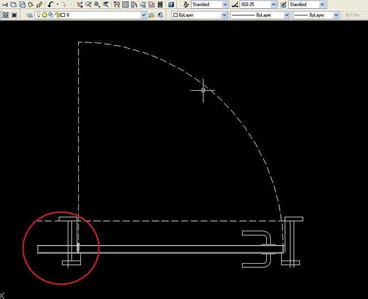

I´ve finished configuring two door blocks with two visibilty states, but can´t seem to overlap the drawings without disconfiguring the block i´m trying to move. What I´m I doing wrong?

After overlaping the blocks in the block editor and saving, the inserted block is disconfigured (see pic). I`ve set up other blocks before with visibility states but without any parameters, I must be missing a step....
I figured out what i was doing wrong. The block wasn´t working as i expected it because I didn´t save it under a new name. :shock:
Cad must of saved original settings and messed up with what i was trying to change.
