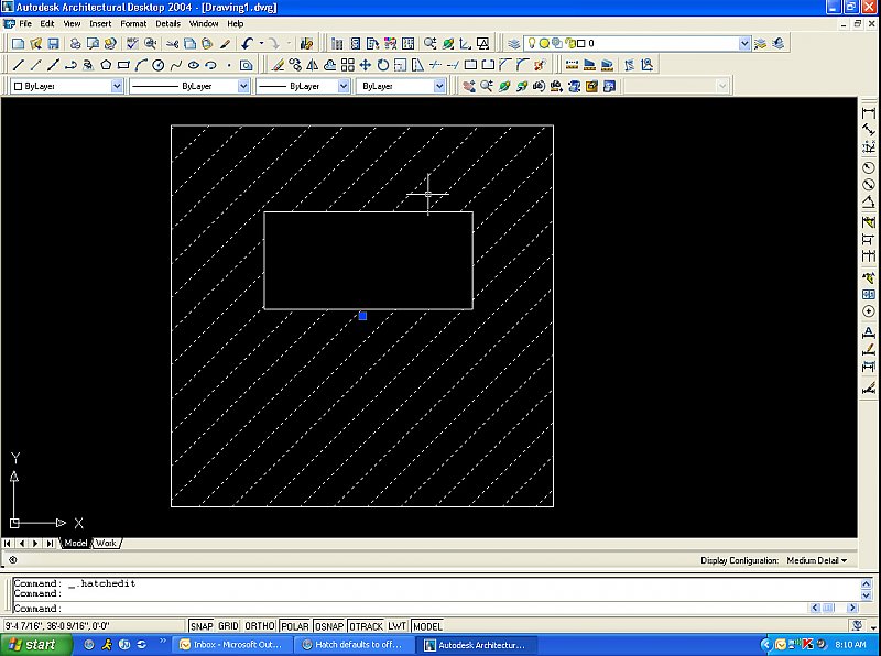

stephenward Posted July 22, 2009 Posted July 22, 2009 when i pick point for hatch: Rather than the hatch sitting neatly around the text it is annoyinly offset. can u help. see attached Quote

CADMASTER1128 Posted July 22, 2009 Posted July 22, 2009 I am showing and example of what to do here. I am not using ANSI 31 hatch pattern. When you want to HATCH select everything you wish to HATCH. Even the inner rectangle. Quote

stephenward Posted July 22, 2009 Author Posted July 22, 2009 i have a box drawn in layer1 i have text within box on layer2 i then 'pick point' solid hatch onto layer1 = strangely offset automatic cut out to hatch Quote
