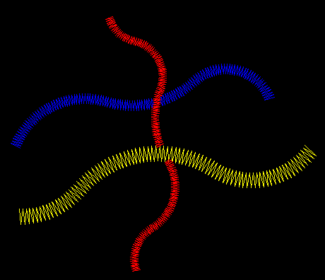

Dave,
Try this and see if it will do.

Thanks Tim. It worked fine. Good routine!

May be use LwPolyline?

  Quote
Nice tubes!
