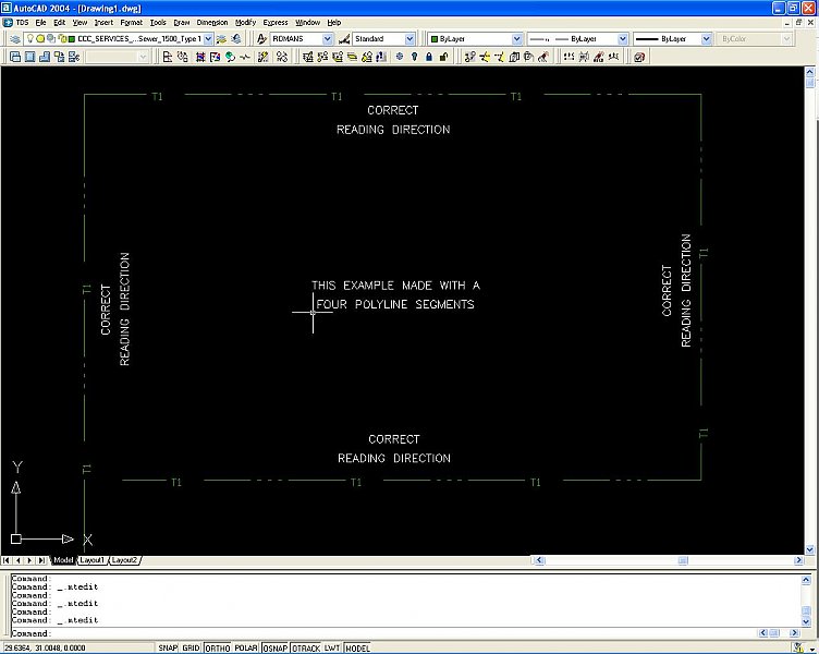

That seems to do it alright. Just one thing though. When I run the lsp it loads the dialog box and when I choose my options and press OK it disappears. I start to draw the pline and at the second point the box reappears and I have to press OK again. the Pline command then starts again. Does the box need to be hidden on the userclick??
Here is the code that I made a few small changes to to get the linetypes to load and the linetype file.
woodman78,
I removed the loop command (POPUP_MF) from the end of the ANSWER function for now. I am working on something else that will make your eyes pop out. I will need a little time to get it done, But in the mean time can you let me know about the line width question I had asked you about. I also removed the real numbers as well since it is not really needed. I have your code functioning well, But I need your reply first.
We will get this all cleared up soon.
The Buzzard
I see your point about the pause twice. I'm out of the office now i'll check it first thing in the morning. Thanks.
No problem, I have something completely different for you. You will find it interesting. I am still working on it at the moment. I will contact you then.
The Buzzard
Look forward to seeing it. I changed the end of the code a bit. I removed the pause and used plinewid instead. Now when i run it the plinewid runs fine but when the pline command kicks in i get the following at the command line.
Command: plinewid
Enter new value for PLINEWID : 0
Command: pline
Specify start point: ._-layer
Invalid point.
; error: Function cancelled
Current line-width is 0.0000
Specify next point or [Arc/Halfwidth/Length/Undo/Width]:
Specify next point or [Arc/Close/Halfwidth/Length/Undo/Width]:
Command:
It seems that the layer command is kicking it at the start of the pline.
I just commented out the (POPUP_MF) at the end of the code and it works fine. It remembers the settings selected previously when I want to draw another line so do i need to loop back to (POPUP_MF)???

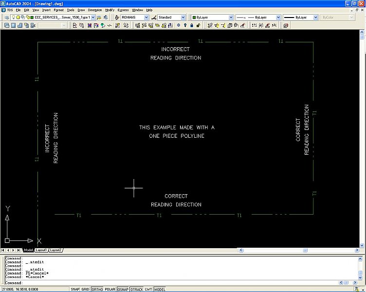

The attached program has some new stuff. I noticed when you use the pline command to draw custom linetypes with lettering, The lettering can come out in the wrong reading direction. I made adjustments to the program to correct this.
I also added a line width edit box if you decide to change line width in this manner. The program still sets your plot line width thru the layers as before so this is just another method since I noticed that line width issue I was mentioning to you. There is also variable save features and restore features. The program will draw line plines in segments rather than constant. This will allow the linetypes to be rotated automatically to correct the wrong text reading direction.
View the images so you can see what I am talking about.
woodman78,
These two lines written the way they were in POPUP3.lsp are the primary cause for the problem in the loop.
    (command "pline" pause "width" "0.0" "0.0" pause "width" "0.0" "0.0" "")
   (command "pline")
I had enquired on these and needed to know what you wanted to do with them. In POPUP4.lsp this is written a different way and is more flexible. If they are not needed, They can be removed. If you do not want to go this way with the program I am open to your suggestions.
I found the last program works well and places the plines in the correct orientation. The pline width is optional as you can always leave it at zero. I posted it as an example for your opinion.
Please let me know how you would like to proceed,
The Buzzard
woodman78,
This is your version! No more dialog loop. I use the while function to make the polylines run continuously as the regular pline command, However the text reading direction is not effected at all. The program has the user settings saved and restores them when the program is complete. An error trap has been placed in the program incase the user hits escape mid-command. I tested this version completely and I must say it works very well. I put alot of effort into this one. I can assure you, This is the version you will want to use.
Give this program the once over.
I believe all will go well.
Look forward to your comments.
Command Syntax: POPUP5
Good Luck,
