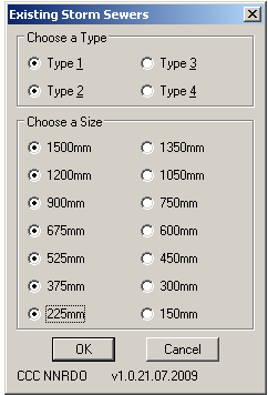

Hi,
I am trying to code a dcl file to create a dialog with a box of 2 columns of 2 radio buttons and under that a box with 2 columns of 7 radio buttons each. I keep getting errors in the dcl. Can anyone help??
Thanks
Can you please post the dcl & lsp files.
Hi,
Thanks
I am posting this as an example based on your description.
I would prefer you post yours so that it can be fixed.

Buzzard,
this is the code I was using:
radio : dialog {    //dialog name
     label = "Existing Storm Sewers" ;  //give it a label
      :boxed_radio_column_1 {   //*define radio column
      label = "Choose a Type" ;    //*give it a label
       :row{
       : radio_button {   //*define radion button
       key = "T1" ;    //*give it a name
       label = "Type &1" ;   //*give it a label
       //value = "1" ;    //*switch it on
       }     //*end definition
     : radio_button {   //*define radio button
       key = "T2" ;    //*give it a name
       label = "Type &2" ;  //*give it a label
     }     //*end definition
     :Row{
       key = "T3" ;    //*give it a name
       label = "Type &3" ; //*give it a label
       }     //*end definition
       key = "T4" ;    //*give it a name
       label = "Type &4" ;  //*give it a label
     }     //*end definition
       }     //*end radio column
      :boxed_radio_column_2 {   //*define radio column
      label = "Choose a Size" ;    //*give it a label
       :row{
       key = "S1" ;    //*give it a name
       label = "1500mm" ;   //*give it a label
       }     //*end definition
       key = "S2" ;    //*give it a name
       label = "1350mm" ;  //*give it a label
     }     //*end definition
     :Row{
       key = "S3" ;    //*give it a name
       label = "1200mm" ; //*give it a label
       }     //*end definition
       key = "S4" ;    //*give it a name
       label = "1050mm" ;  //*give it a label
     }     //*end definition
ok_cancel ;    //predifined OK/Cancel
    : row {     //define row
    : paragraph {    //define paragraph
    : text_part {    //define text
    label = "Designed by Brian Deasy";  //give it some text
    }      //end text
    : text_part {    //define more text
    label = "for CCC NNRDO";   //some more text
    }      //end text
    }      //end paragraph
    }      //end row
    }      //end dialog

Your example was great. The one thing I wanted to do differently was that I wanted just one box per row but to keep the button layout so that would be 4 in the first box and 14 in the second.
Thanks
Thanks
From the above description I think this is what you want.
Not sure, However I do not recomend this type of layout as it is much too long in height. Let me know.

Here is your dcl and a lsp I provided for testing.
Your main problem was naming the boxed_radio_column which you called boxed_radio_column_1 so on & so forth.
You also had some rows misplaced and no columns.
Please try to develope a neater format, It will help to avoid some mistakes.
I will let you finish the rest. Use the examples I provided above.
If you should get stuck, Let me know.

Here is the above code formated, I think the way you wanted.
Please let me know if this is OK.
All new radio buttons added have a (?) for the label. I did not have the info.

Thanks for that Buzzard. What I was trying to do was as you have done but instead of having one column which makes the window long, was to have two columns but with the boxes as you have them? Is that possible??
Many things are possible, But try to make the attempt. You need to take out the (: row {) and its end bracket (}) on the second group of buttons. Try to keep a neat format.
I would suggest you trying to use a popup list to save space instead of the radio buttons. If I get some time I could make an example for you. I am just a little busy at the moment. A popup list will save you alot of space, But would involve less dcl coding and more lsp coding. Just something new for you to learn.
Good Luck
I got that sorted Buzzard but ran into another little problem. When the dialog is loaded I can select one item per row. I have been looking at examples on the web and they seem to only have one or one column per boxed_column.
radio1 : dialog {                                 //*dialog name
       label = "Existing Storm Sewers";         //*give it a label
      : row {                                  //*define row
         : column {                             //*define column
          : boxed_radio_column {               //*define radio column
             label = "Choose a Type";           //*give it a label
                key = "T1";                      //*give it a name
                label = "Type &1";               //*give it a label
              //value = "1";                     //*switch it on
              }                                  //*end definition
                key = "T3";                      //*give it a name
                label = "Type &3";               //*give it a label
              }                                  //*end definition
                   }                                        //*end row
                key = "T2";                      //*give it a name
                label = "Type &2";               //*give it a label
              }                                  //*end definition
                label = "Type &4";               //*give it a label
              }                                  //*end definition
                    }                                        //*end row
          }                                    //*end boxed_radio_column
         }                                      //*end column
      }                                        //*end row
             label = "Choose a Size";           //*give it a label
                label = "1500mm";                //*give it a label
              }                                  //*end definition
                key = "S2";                      //*give it a name
                label = "1350mm";                //*give it a label
              }                                  //*end definition
                   }                                        //*end row
                key = "S3";                      //*give it a name
                label = "1200mm";                //*give it a label
              }                                  //*end definition
                key = "S4";                      //*give it a name
                label = "1050mm";                //*give it a label
              }                                  //*end definition
                   }                                        //*end row
                key = "S5";                      //*give it a name
                label = "900mm";                     //*give it a label
              }                                  //*end definition
                key = "S6";                      //*give it a name
                label = "750mm";                     //*give it a label
              }                                  //*end definition
                   }                                        //*end row
                key = "S7";                      //*give it a name
                label = "675mm";                     //*give it a label
              }                                  //*end definition
                key = "S8";                      //*give it a name
                label = "600mm";                     //*give it a label
              }                                  //*end definition
                   }                                        //*end row
                key = "S9";                      //*give it a name
                label = "525mm";                     //*give it a label
              }                                  //*end definition
                key = "S10";                     //*give it a name
                label = "450mm";                     //*give it a label
              }                                  //*end definition
                   }                                        //*end row
                key = "S11";                     //*give it a name
                label = "375mm";                     //*give it a label
              }                                  //*end definition
                key = "S12";                     //*give it a name
                label = "300mm";                     //*give it a label
              }                                  //*end definition
                   }                                        //*end row
                key = "S13";                     //*give it a name
                label = "225mm";                     //*give it a label
              }                                  //*end definition
                key = "S14";                     //*give it a name
                label = "150mm";                     //*give it a label
              }                                  //*end definition
                   }                                        //*end row
         }                                      //*end column
       }                                        //*end row
           ok_cancel ;                            //*predifined OK/Cancel
           : paragraph {                          //*define paragraph
             : text_part {                        //*define more text
               label = "CCC NNRDO       v1.0.21.07.2009";           //*some more text
             }                                    //*end text
           }                                      //*end paragraph
         }                                        //*end column
       }                                          //*end row
     }                                            //*end dialog
             }                                  //*end definition
             }                                  //*end definition
             }                                  //*end definition
         }                                      //*end column
       }                                        //*end row
         : boxed_column {                       //*define boxex_column
           : popup_list {
             key = "S1";
             edit_width = 8;
           : spacer {
             height = 0;
         }                                      //*end boxed_column
       }                                        //*end row
             : text_part {                        //*define text
               label = "Designed by Brian Deasy"; //*give it some text
             }                                    //*end text
               label = "for CCC NNRDO";           //*some more text
             }                                    //*end text
           }                                      //*end paragraph
         }                                        //*end column
       }                                          //*end row
     }                                            //*end dialog

woodman78,
Again I do not have your linetypes, So I am working blind folded here.
Use the dcl & lsp below. I had to remove some paren from you additions.
Program now stops to look for the linetype as I have mentioned I do not have.
This should work for you.
Type POPUP3 to start.
Just make sure you use both codes below only.
DCL
popup3 : dialog {                                   //*dialog name
            : popup_list {
              key = "T1";
              label = "Type";                      //*give it a label
              edit_width=8;
              alignment = centered;
            : spacer {
              height = 0;
          }                                        //*end column
        }                                          //*end row
            : popup_list {
              key = "S1";
              label = "Size";                      //*give it a label
              edit_width=8;
            : spacer {
              height = 0;
        }                                          //*end row
              }                                    //*end text
              }                                    //*end text
            }                                      //*end paragraph
          }                                        //*end column
        }                                          //*end row
      }                                            //*end dialog

That seems to do it alright. Just one thing though. When I run the lsp it loads the dialog box and when I choose my options and press OK it disappears. I start to draw the pline and at the second point the box reappears and I have to press OK again. the Pline command then starts again. Does the box need to be hidden on the userclick??
Here is the code that I made a few small changes to to get the linetypes to load and the linetype file.
(defun C:POPUP3 ()
 (POPUP_MF)
(defun POPUP_MF (/ HOLE$ SIZE$ SIZE# HOLE SIZE a b)
 (setq SIZE# 1500)
 (setq T1_list
  '("Type 1" "Type 2"
    "Type 3" "Type 4"))
 (setq S1_list
  '("1500mm" "1350mm"
    "1200mm" "1050mm"
     "900mm"  "750mm"
     "675mm"  "600mm"
     "525mm"  "450mm"
     "375mm"  "300mm"
     "225mm"  "150mm"))
 (setq dcl_id (load_dialog "popup3.dcl"))
 (if (not (new_dialog "popup3" dcl_id))
     (alert "Can not find your dcl file")
     (exit)))
 (start_list "T1")
 (mapcar 'add_list T1_list)
 (end_list)
 (start_list "S1")
 (mapcar 'add_list S1_list)
 (end_list)
 (if HOLE2:DEF
   (set_tile "T1" (itoa HOLE2:DEF)))
 (if SIZE2:DEF
   (set_tile "S1" (itoa SIZE2:DEF)))
 (action_tile "cancel"
  "(done_dialog)(setq userclick nil)")
 (action_tile "accept"
   (strcat
    "(progn
     (setq H:OLE2 (atoi (get_tile \"T1\")) HOLE2:DEF H:OLE2)"
    "(setq S:IZE2 (atoi (get_tile \"S1\")) SIZE2:DEF S:IZE2)"
    "(done_dialog)(setq userclick T))"))
 (start_dialog)
 ;(unload_dialog dcl_id)
 (if userclick
     (VARIABLE)
(defun VARIABLE ()
   (setq HOLE$ (fix H:OLE2))
   (setq HOLE$ (nth H:OLE2 T1_list))
   (cond
     ((= HOLE$ "TYPE 1"))
     ((= HOLE$ "TYPE 2"))
     ((= HOLE$ "TYPE 3"))
     ((= HOLE$ "TYPE 4"))
 (setq HOLE HOLE$)
   (setq SIZE$ (fix S:IZE2))
   (setq SIZE$ (nth S:IZE2 S1_list))
   (cond
     ((= SIZE$ "1500mm")(setq SIZE# 1500))
     ((= SIZE$ "1350mm")(setq SIZE# 1350))
     ((= SIZE$ "1200mm")(setq SIZE# 1200))
     ((= SIZE$ "1050mm")(setq SIZE# 1050))
     ((= SIZE$  "900mm")(setq SIZE#  900))
     ((= SIZE$  "750mm")(setq SIZE#  750))
     ((= SIZE$  "675mm")(setq SIZE#  675))
     ((= SIZE$  "600mm")(setq SIZE#  600))
     ((= SIZE$  "525mm")(setq SIZE#  525))
     ((= SIZE$  "450mm")(setq SIZE#  450))
     ((= SIZE$  "375mm")(setq SIZE#  375))
     ((= SIZE$  "300mm")(setq SIZE#  300))
     ((= SIZE$  "225mm")(setq SIZE#  225))
     ((= SIZE$  "150mm")(setq SIZE#  150))
 (setq SIZE (RTOS SIZE# 2 0))
 (ANSWER)
(defun ANSWER ()
   (setq a (strcat "CCC_DR_" SIZE "_" HOLE)
         b (strcat "CCC_SERVICES_EXISTING_Drainage_Storm_Sewer_" SIZE "_" HOLE)
   (if
     (not
       (tblsearch "LTYPE" a)
     (command "_.-linetype" "_l" a "acadiso.lin" "")
   (command "._-layer"   "_N"   b   "_M"   b   "_L"   a  b   "_C"   "84"   b   "_LW"   "0.3"   b    "" )
   (command "pline" pause "width" "0.0" "0.0" pause "width" "0.0" "0.0" "")
   (command "pline")
 (POPUP_MF)
acadiso.txt
