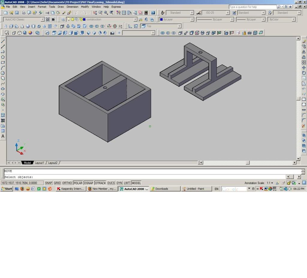

grandmaster87 Posted July 19, 2009 Posted July 19, 2009 Hi i am new here. i joined the forum because i need help doing my project. basically i have a structure and at the bottom it has drainage holes. so i drew the front sectinal view and top view and was wondering if anyone can help me convert it to a 3d model. it took me 5 mins to draw on cad. its the only thing i cant seem to draw. also i attached the other drawing i have done ... its in a 3-d model , tell me if its alright and what can be done to make it better. im in school and we started using autocad this year...and i really want to grow my knowledge with this software. hope you guys like my designs...and can help me out i saved all the files as autocad 2000 so at least most of the people can view it. dhiven Briquette Machine Casing_autcad2000.dwg pressplate_3dmodel_autocad200.dwg Quote
deres Posted July 19, 2009 Posted July 19, 2009 I converted it to 3d...let me know your questions. Briquette Machine Casing_autcad2000.dwg Quote

deres Posted July 19, 2009 Posted July 19, 2009 Now, the proccess for our friend grandmaster87. First of all, switch to isometric view. Using the extrude command, you extrude the two outer rectangles, giving 90 height. Then, you must subtract the small rectangle from the outer. You do this with substract command, selecting first the outer rectangle and then the inner one. It's one solid now. Now for the central object. Simply select both the rectangle and the circle and move them at "z" (up) direction. Before the "move" command finishes, acad is asking for second point of displacement. Type "10" and "enter". Now they are at the right place. Extrude them both with a height of 10 and subtract the cylinder from the box, as we did before. Now for the draining base, draw a new rectangle (we used the original at the first step) at the bottom of the solid, snapping at the inner rectangle's edges. Select it and all the small circles and move them at z (up) direction typing 10 again when acad ascs for second place of displacement. Select them again and extrude them giving -10 as height. Finally subtract all the small cylinders from the "drainage" surface (you know now how) and you are ready! Quote

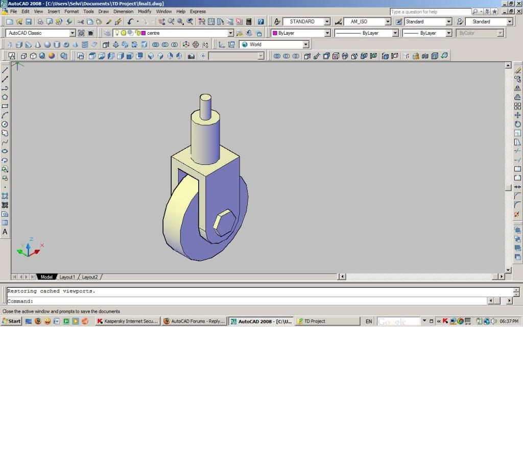

grandmaster87 Posted July 19, 2009 Author Posted July 19, 2009 Ok since you guys are taking a hit on me:twisted: jus joking... here is something else i designed:) its a castor for a trolley company.. Quote

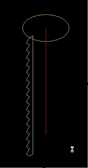

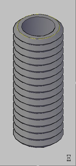

deres Posted July 19, 2009 Posted July 19, 2009 Personally, when I want to make threads to a round hole, I first draw a polyline like this. You can make it to match your thread settings. With white color is the polyline, yellow is the diameter of the hole, and red is the vertical axis of the hole. After you make the polyline, which is the section of the feminine threads, you select it and use the "revolve" command, using the red line (pick top and bottom) as a revolve axis. You must get something like this Subtract it from your solid and you are ready. PS It's not the correct method to make a thread, but it looks almost the same... Quote

deres Posted July 19, 2009 Posted July 19, 2009 Grandmaster87, forget about the helix and the circle, it was my mistake...I tried it and it didn't look good. It takes a helix as a path and a 45' rotated square to look like thread.... I suggest you use the second method that I posted instead. Quote
