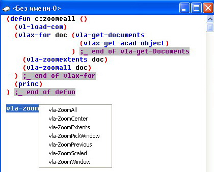

VVA Posted July 17, 2009 Posted July 17, 2009 (defun c:zoomeall () (vl-load-com) (vlax-for doc (vla-get-documents (vlax-get-acad-object) ) ;_ end of vla-get-Documents (vla-zoomextents doc) (vla-zoomall doc) ) ;_ end of vlax-for (princ) ) ;_ end of defun To find the name vla function, use autocompletion In Visual lisp editor type vla-zoom, then press Ctrl + Shift + Space (see attach) Quote
VVA Posted July 17, 2009 Posted July 17, 2009 Remark. vla-zoomextents, vla-zoomall work only with active document. http://discussion.autodesk.com/forums/message.jspa?messageID=1184966 (vla-ZoomExtents (vlax-get-acad-object)) Quote
