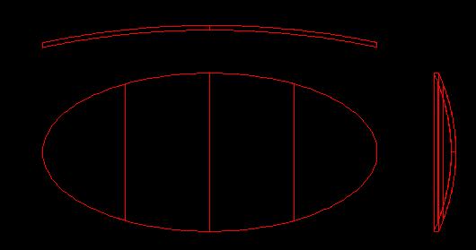

Hoozin Posted April 23, 2008 Posted April 23, 2008 This may be a little bit simpler than you're looking for, and I can only figure out the backing really. If you've got the design curved onto it (as opposed to flat and attached to the curved backing), then I need to spend a lot more time looking at how to What I did was made an arc, copied it to a distance equal to the thickness of the backing, made a poly line out of them, and extruded the resulting cross section up. I then made an ellipse (this can be really any shape that you want the outline of the buckle to be - I just went with the traditional cowboy thing) that I liked the dimensions of, extruded it, put it through the middle of my extruded arcs solid, and then used the Boolean INTERSECT to give me this object that really looks more like a pringle than a belt buckle, but you get the idea. Let me know if this was even remotely helpful please. Quote
Hoozin Posted April 23, 2008 Posted April 23, 2008 smorales02 said: Is there suppose to be an image??? Nope, I rely on others to read my mind to determine what I'm talking about. BuckleBacking.dwgFetching info... Quote
rustysilo Posted April 23, 2008 Author Posted April 23, 2008 :shock:"YES! YES! That's sooo much better!" (Sorry. Had a Dead Milkmen flashback.) Now I am seeing the light, or at least a glimmer of it. Thanks a bunch. I'll report back if I need more advice.:wink: Quote
