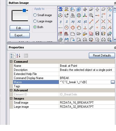

stevsmith Posted July 14, 2009 Posted July 14, 2009 In the cui, change the macro setup to this. The macro reads currently. ^C^C_break \_f \@ add the * to the beginning *^C^C_break \_f \@ Quote
lpseifert Posted July 16, 2009 Posted July 16, 2009 repeats the macro; similar to issuing Multiple prior to a command Quote
