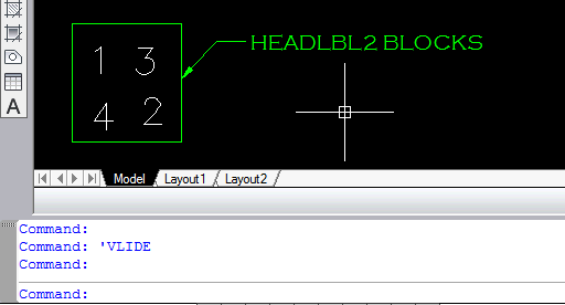

Ok, well I guess this is where it might get a little complicated. I can give you the blocks for the pipelbl and head label, but the head label block does not have attributes added to it. There is another lisp routine that we use to tell it what type of sprinkler head to use, what gpm, etc. And of course, this lisp routine fills in the pipelbl attributes. So I hope this is enough for you to work off of. Thanks a million.
HEADLBL2.dwg
Pipesize.dwg
Ahh, I see what the problem is - the GPM attribute is invisible - will have a re-think :)
Ok, this is a much simpler (but less elegant) way of coding it.
I have set it to "remember" the heads and gpmsum that you have added, but I have left the rest of the code mostly how you had it with regards to calculating the pipelength etc.

Ok, thanks for all your help first of all!
When I run it, it doesn't seem to be tallying up the gpm (or attribute) of each head I select. It will give me the option to Add, Replace or Calculate, I hit 'a' for add and click a head, then I can hit enter and hit the next head, and so forth. When I type in 'c' for calculate, it asks for pipe length, which I enter. And the result is 1/2", which is fine, but i know that the pipe size should have been bigger because the sum of the attributes clicked should have fallen in the range of a bigger size pipe.
The other problem is that the resulting pipe size label is coming out at the wrong scale. We set our drawings at decimal, and will do things at 1"=10', 20' or 30'. So at 1=10 the scale of labels would be .083. However, this scale is set in the drawing by yet another routine. So somehow with the old code, it knew which scale to use. These are coming out much bigger.
I wish there were a way for me to show you how the old program worked. That would probably make it much easier for you.
I see, I didn't know about the scale being set by another routine. This means that the variables are global which isn't ideal. I have set the scale to be retrieved from the USER2 sys var, but I am not sure what that is being set to.
As for the GPM being collected, I tested it, and it seems to accumulate:
Ok, well first off, I'm an idiot. I gave you the wrong head label block, once I changed it to the right block, it started adding the attributes. However, once it got to actually bringing in the pipe label, it was making me enter x, y, z size. But that is actually a secondary problem now :?.
When I first entered in the new lisp, I was in a drawing, I saved the lisp, and it recognized the command. But then when I went to another drawing, I had loaded the menu and everything the same way, it was not recognizing the command. So I closed all drawings, reopened, loaded the menu's, and now it gives the following in the command line:
