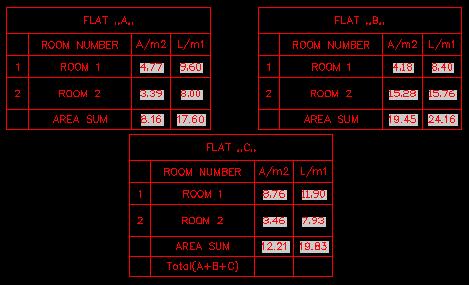

I have a few indipendent table that have a cell with formula SUM.
I need to create final formula SUM that will do SUM of all "SUM" cells that belongs to different table.
So how to SUM value from cells that belong to different tables.
Thansk
Are these tables in exel then datalinked?
No, these tables are created in Autocad
Here is a picture that will put more details in my request.
So, I have a number of tables thar represents data for a flats (Area and Length of room).
In each table there are Formulas SUM in a row "Area Sum" such as =Sum(E3:E4) that represents Sum for each room in flat.
All I need is to put SUM in a row "Total(A+B+C)" in last table for each Table's Area Sum row.
My main problem is how to sum up cells from different table?
Tables are created in Autocad 2008.
Thanks
I don't think you could achieve this with a table formula, as they are only linked to the table in question.
I found somewhere "=Table(2120389024).B3" where number I supposed is ObjId.
Would this help.

Lee Mac, you are genious. What to say.
Just I have different conversion factor for Area (.0001) and Length (.01).
How to do it when putting total.
Just alter the formula afterwards to include *0.001, or whatever.

reopening this thread since I'm searching for the same solution.
I tried the attached lisp routine but I only get ##### in return from the table summation
looking at the formula it can look something like this:
=Table(52).A1+Table(46).A1+Table(45).A3
although when I choose formula>cell it gives something like =Table(8796053525552).A1 for table(52).A1
Is there a solution to this? (using 2009)
noone?
I think the problem lies within the table.objectid property collected. This is seemingly different from the id collected using formula->cell.
Gruesome enough I can't find the strange code (879...) in any dxf code property for the table.
:wacko:
