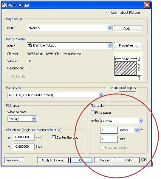

How can I print a full size drawing(1=1 scale) on my HP printer
which prints only 8.5x11"? I use Autocad 2010 64bit.
Thanks.

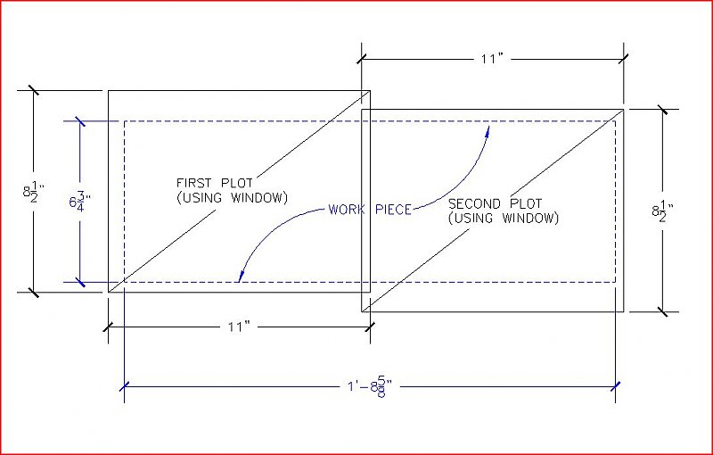

How large is the drawing itself? If larger than 8 x 10.5 then you will need to draw rectangles the size the printer can actually handle at full scale (some experimentation might be needed). Place the rectangles on a non-plot layer. Now plot using Window and picking the opposite edges of each rectangle. Or you can set named views if you are going to do this a lot.
Or you can do this in paper space with that size, multiple layouts so you can use publish.
When printing you just need to adjust the scale. See attached image.

The actual size of the drawing is 6.75x20.625" which I'd like
to use as a template to trace onto the work piece. I wish
there was an easier way of doing this. Do you know of any CAD
programs that are capable of doing the job directly from the print(plot)
command?
this help?
then tape the 2 together?

Thanks much again.I went ahead and did exactly what
you suggested and it worked fine. I appreciate your help.
