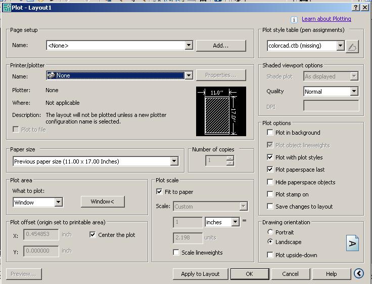

Here is the screen shot of the issue.

notice in the upper right side your colorcad.ctb file is missing you need to find it and put it in the appropriate file (where all your ctb files are)
Ok the first thing I see right away is at the top right of the dialog box you are missing your ctb file. You need to find it and reload it. If you have others you work with they may have a copy of it they can email you and you can cut and paste it where it belongs.

The other thing is you don't have a plotter loaded.
the ctb file should be whatever your office standards say to use. if it should be colorcad.ctb then you need to find it and put it with the rest of the ctb files
Why don't you try the monochrome.ctb and see if that one gives you the results you need.

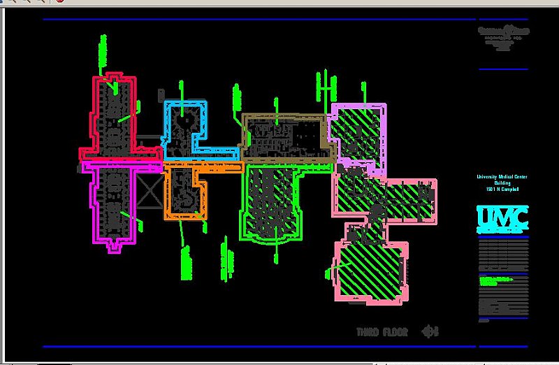

Can you screen shot what the plot preview looks like?
What are the DPI settings in your printer? in the plot dialog box next to the printer select properties then locate what the DPI is set to. Sometime our preview is trashy when we don't have the DPI set to at least 400. This is sometimes the case when plotting to a PDF writer but sometimes when printing.

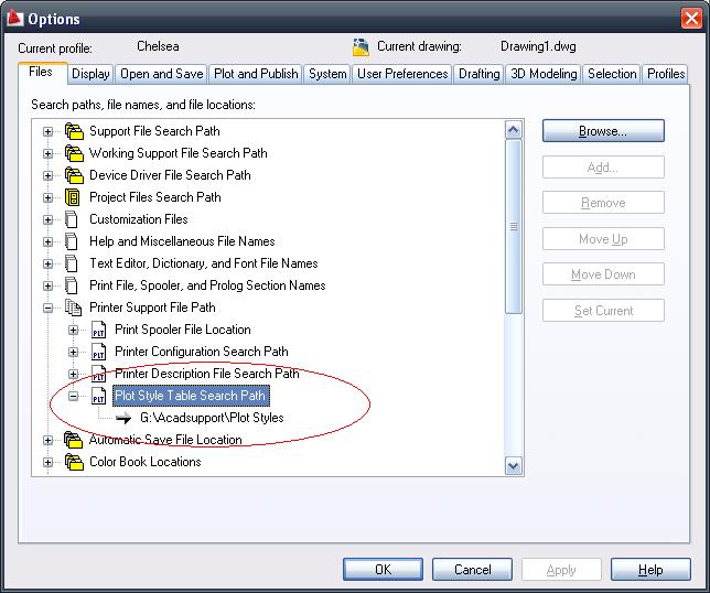

once you find it you want to put it in the file shown on your options, files - plot style table search path
The DPI settings didn't change the preview. The highest I could go though was 300.

Do you have a co-worker that has it? It should be located in your ACAD printer support files area (plotstyles)
