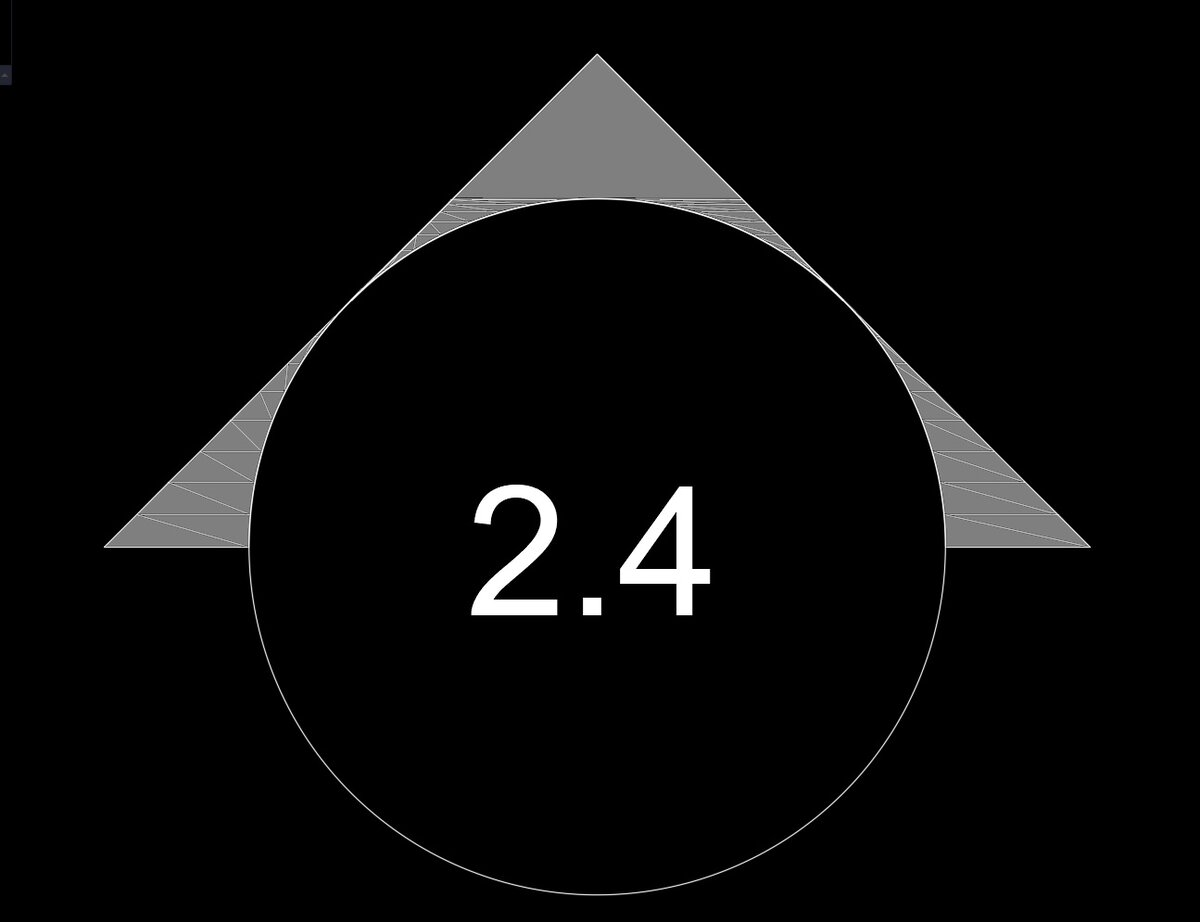

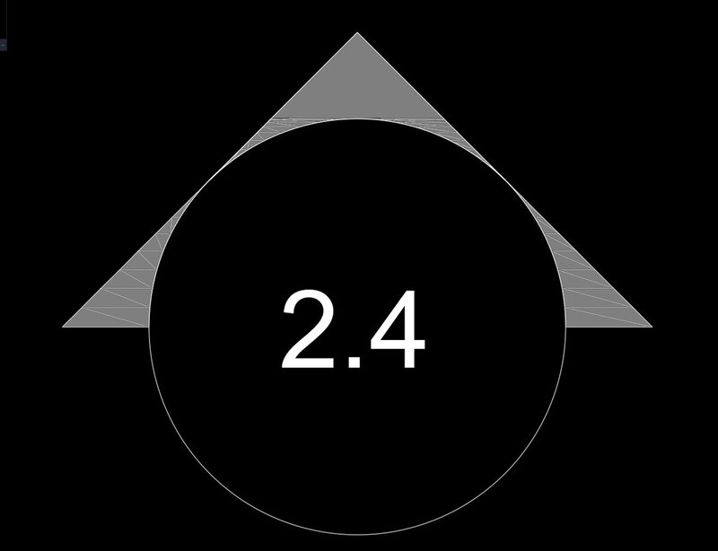

ammobake Posted January 8, 2021 Posted January 8, 2021 I've often wondered about this and it's an interesting observation. An interesting side note - and something you can try at home - Take a drawing with solid hatch. Print the hatched object DWG to PDF, take that PDF and down convert back to DWG in Autocad 2021. You will notice that one hatched area is treated very strangely. If you convert the PDF back to DWG and insert it as block, go into the block editor. You will notice something that looks similar to this..... I'm assuming what is going on here is Autocad is scanning the PDF as it converts - breaking down the vector graphics and linework into objects recognizable by Autocad in the most efficient manner it sees fit. In the case of a hatch (example being the block above) it converted this one to 68 triangular "SOLIDS". So it must have considered 68 triangle solids the most efficient use of processing power when producing the conversion. Furthermore, they show up as a grey color (like color 252 or something). But the layer is white and they print as solid black. So that's possibly just the visual style stuff coming into play I dunno. But it's interesting. Thought I would share lol. Kind of a neat, handy little trick for someone wanting to convert a bunch of hatches into solids perhaps. But that's a pretty niche kind of application. -ChriS Quote
