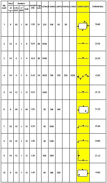

Mr Lee Mac,
How do we copy polyline entities with length segment to table like Autocad Structural Detailing? (Attached image is from Autocad Structural Detailing - reinforcement).
Thank you.
m4rdy

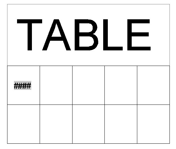

Hello everyone,
I've tried to use this to automate area and lenght input into tables but always get #### in cell. What am i doing wrong?
Edited by Misko78
