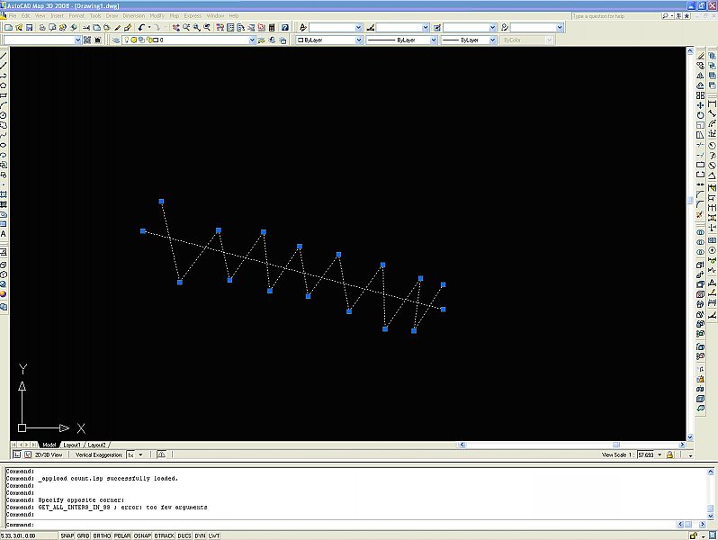

nickg2027 Posted July 7, 2009 Posted July 7, 2009 I have searched high and low for the answer to this. I have found a few programs that people have written for macros to list the coordinates for the intersections of plines. I simply need the total count of intersections. Some of my projects are extremely large and the number of insections can easily reach 100,000. I am drawing a simple 2-d drawing that has transects spaced every 140 ft with intersecting lines every 40 ft. Any help would be greatly appreciated. Quote

nickg2027 Posted July 9, 2009 Author Posted July 9, 2009 Still can't get it to work? The Command Line tells me error: too few arguments. I just want autocad to tell me that in this drawing there is "14" intersections. Any help would be appreciated. I'm at a loss?? Quote

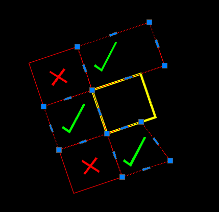

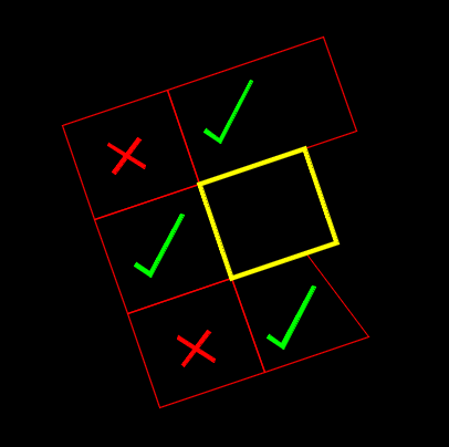

Engineer_Yasser Posted November 1, 2023 Posted November 1, 2023 11 hours ago, Lee Mac said: The ActiveX intersectwith method can be inaccurate when objects are far from the origin (presumably due to the limited precision afforded by the double-precision floating point format); if you move your objects close to the origin, you'll find that the program returns 1 intersection. As such, a possible solution might be to temporarily move the selection set close to the origin prior to calculating the intersection count, before restoring the position of the set. Do you have any idea how to select closed polylines that touch the yellow closed polyline ( not intersected at one point ) as in picture Test 2.dwg Quote
Lee Mac Posted November 1, 2023 Posted November 1, 2023 Yes - for every yellow segment, you can test whether the segment is collinear with a red segment and if so, whether the extents of both segments is less than the sum of their individual lengths (i.e. testing that they overlap). 1 Quote
