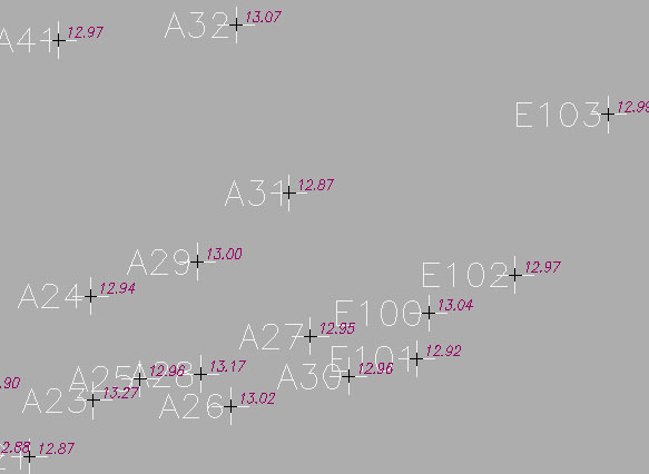

When I started drawing up survey drawings, the end user (architects mostly) could not understand blocks and attributes, so in my desire to keep things simple, I only use entities, and am most suspicious of the blocks with attributes, which used to be sooo inflexible.
So to begin every drawing, I plot the point number with a point, a cross at the point, and the elevation alongside as per the picture. Then you join up the points using the field sketches. Makes a nice drawing with only entities in it, and useable by all. :D

If you can find out how to download the coordinates in a text file, then in the fullness of time, you will be able to your own Lisps. I have provided the picture to see what you want to aim for, and the rest is down to a bit of graft! Being self-employed gave me an added incentive to write something if I wanted to start earning any money.
