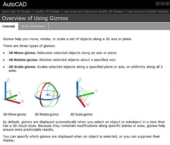

Does 2009 have the "gizmos"? I think they can be quite useful for 3D transformations...
