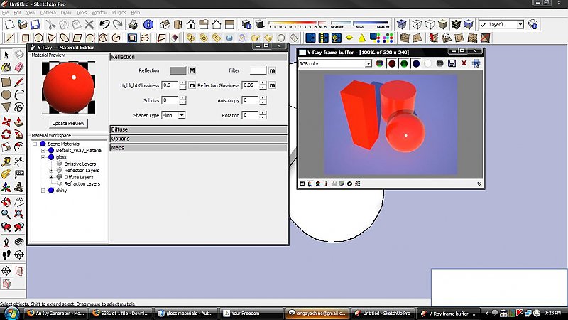

warren architecture Posted July 3, 2009 Posted July 3, 2009 applogies I'm just getting used to sketch up as I'm teaching myself how to use it. anyone know how to make a materail look glossy? PLMK Quote

warren architecture Posted July 10, 2009 Author Posted July 10, 2009 I'm using the Sketch Vray plugin to do my renders, just stuck on how to make some materials look glossy Quote
papagyi Posted July 10, 2009 Posted July 10, 2009 you can play with highlight glossiness & reflection glossiness value. you can see attach image what i means! Quote

papagyi Posted August 5, 2009 Posted August 5, 2009 I showed above setting for glossy and explained what value you should play! Quote
