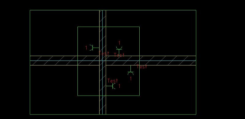

Lee Mac Posted July 2, 2009 Posted July 2, 2009 (edited) With the recent influx of requests for LISPs that will alter multiple attributes, I have decided to create this Attribute Modification Suite. Currently, it contains three functions: MvAtt, RoAtt & EdAtt, these will Move, Rotate and Edit multiple attributes respectively. Any suggestions, comments, (and of course, bug reports!), are welcome Enjoy, Lee Code available here. Edited November 5, 2010 by Lee Mac Quote

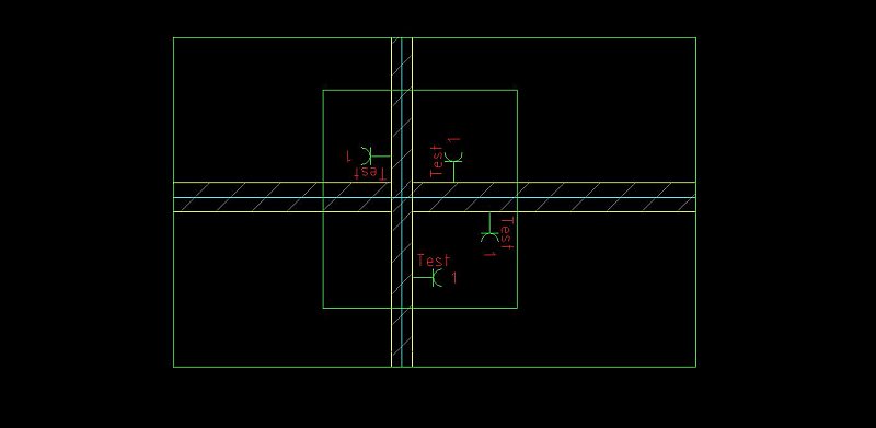

MarcoW Posted July 3, 2009 Posted July 3, 2009 Lee, you said: ... the hardest part is thinking of what to make/add to the programs. There is where I come in haha, I allways manage to come up with probs that other people must solve... But I'm too busy with my work that I can't spend enough time figuring out decent lisp programming. That's why I am that enthousiast whenever you come up wit an idea, solution or just a routine to try. (I shouldn't be doing that either if it where my boss to say)... BTW, I draw electrical plans and do a lot of engineering, so I have lots of block with attributes. The routine I found (atrot.lsp) I now use to rotate my attributes work quite nice. Allthough one thing still annoys me. (defun c:atrot (/ blSet attLst errCount tmp) (or atrot:tag (setq atrot:tag "")) (setq tmp (getstring (strcat "\nSpecify Tag to be Rotated <" (if (eq "" atrot:tag) "*all*" atrot:tag) ">: "))) (or (eq "" tmp) (setq atrot:tag tmp)) (princ "<<< Select blocks to rotate attributes >>>") (setq errCount 0) (if (setq blSet (ssget '((0 . "INSERT") (66 . 1)))) (progn (setq blSet (mapcar 'vlax-ename->vla-object (vl-remove-if 'listp (mapcar 'cadr (ssnamex blSet))))) (foreach itm blSet (setq attLst (vlax-safearray->list (vlax-variant-value (vla-GetAttributes itm)))) (foreach att attLst (and (eq (if (eq "" atrot:tag) (vla-get-TagString att) atrot:tag) (vla-get-TagString att)) (if (vl-catch-all-error-p (vl-catch-all-apply 'vla-put-Rotation (list att 0.0))) (setq errCount (1+ ErrCount))))))) (princ ">>> Nothing selected! <<<")) (if (/= 0 errCount) (princ (strcat "\n>>> " (itoa errCount) " attributes or blocks were on locked layer! <<< "))) (princ)) Why shouldn't my blocks be inserted with the right kind of attribute rotation? There is a lisp that should do it but it never worked for me. Another prob with the atrot is (see the images below) the justification of the attribute. I can't explain but you see... This is how I use it: Attribute rotation = 0 then leave it Attribute rotation = 90 then leave it Attribute rotation = 180 then rotate to 0 Attribute rotation = 270 then leave it Attribute rotation = else then leave it Quote
Lee Mac Posted July 3, 2009 Author Posted July 3, 2009 The rotation problem you are encountering when using the LISP program is caused by the Justification setting of the attributes in your blocks. Set it to Middle Center and all should be fine. I recognise the LISP you posted as I believe it is a modification of ASMI's original LISP that I modified a while back. I may consider changing my above program to include block selection/all option instead of just defaulting to all. Lee Quote

Lee Mac Posted July 6, 2009 Author Posted July 6, 2009 Sorry for all the updates, but I have now added a "match" rotation ability for the RoAtt function and also fixed quite a few bugs... You can also now press "a" during the block selection to select all blocks, and the Advanced Text Editor Dialog is hopefully now free from bugs! Lee Quote
MarcoW Posted July 6, 2009 Posted July 6, 2009 Hi Lee, Awesome Lisp !! One thing for mvatt and roatt: After selecting blocks, one needs to specifiy the base point. When done, the second point is promted for. If escape is pressed in between those 2 points it should cancel the command. Cancelled it is, but the attributes do not flip back to their origins. I guess it can be fixed by you. On the other hand "a control+z" does the job too. But since you are in for comments I thought I'd share it. By the way, do you know what lisp stands for? Me too but it could also be "Lee Is Splendid Programmer" (We might start a topic on that one ) Cheers, Marco. Note: reply was written before version 5... Nice Lisp with DCL inside. Quote
Lee Mac Posted July 6, 2009 Author Posted July 6, 2009 Hi Lee, Awesome Lisp !! One thing for mvatt and roatt: After selecting blocks, one needs to specifiy the base point. When done, the second point is promted for. If escape is pressed in between those 2 points it should cancel the command. Cancelled it is, but the attributes do not flip back to their origins. I guess it can be fixed by you. On the other hand "a control+z" does the job too. But since you are in for comments I thought I'd share it. By the way, do you know what lisp stands for? Me too but it could also be "Lee Is Splendid Programmer" (We might start a topic on that one ) Cheers, Marco. Note: reply was written before version 5... Nice Lisp with DCL inside. Thanks Marco I'm loving that acronym... Good point about the MvAtt and RoAtt functions, I noticed that too - will have to attempt to fix it Thanks for the suggestions and compliments ~ glad you like it mate Lee Quote
