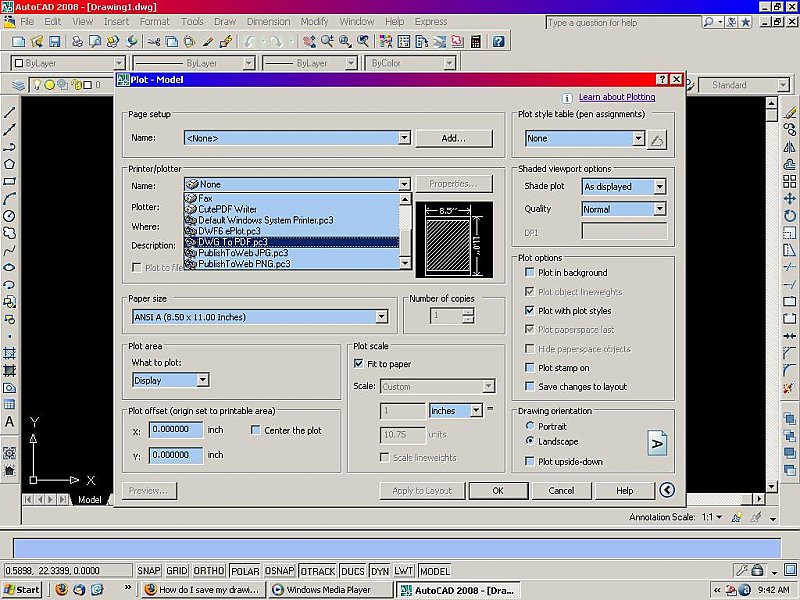

you have to print/plot it to a PDF

That's what a pdf is. It's an electronic printout of your drawing. Just plot your pdf and then stick it on a flash drive and take it down to kinko's. They should be able to print it for you.
When you plot to PDF, you do not get any lines on paper, but you get a PDF file. AutoCAD has funny ways of doing some things, but you will get used to it!

Plot to *.pdf and you could probably email to your local Kinko's for printing.

If your drawing name is xxxx.dwg your *.pdf file will be named xxxx.pdf.
