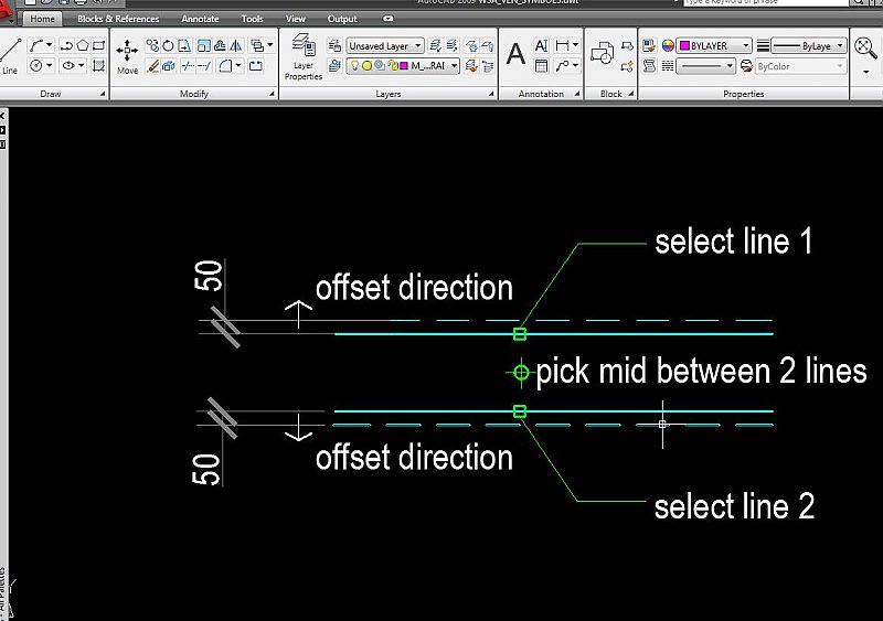

Hi all,
Please to help me to provide a multi-offset Lsp route, this route will select 1 or 2 lines and then pick the reference point other side of the line/pline or pick on mid between selected 2 lines then offset by 50mm, and it automatically change the line to hidden, :) see attached image what would be look like,
Many thanks to all,
I tried a different approach :)

Thanks Lee,
Very fast creating codes:lol:
only one thing i have a problem on UCS, i'm trying to modify and add a TRANS code but it does'nt work, :P
See the code above, I have updated it hopefully to include UCS compatibility...
It work,:shock: solved :D
Thanks Lee,
