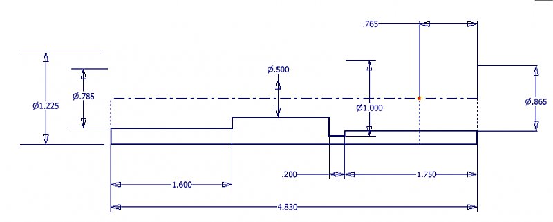

I would like to see your simplied version step by step.
In the attached picture the resolution didn't come out quite right - some of the dimension extension lines look too thick, like object lines, especially the Ø.785 and the .765 Do not let these confuse you.
Create Sketch1 as shown.
Start with a Rectangle just below the origin.
Change the end lines to constuction and the top line to centerline type.
Add a coincident constraint between the projected origin and any location on the centerline (except the endpoints or centerpoint).
Dimension the overall length and the major diameter.
Add additional lines and dimensions as in sketch.
Attach what you have so far here and I'll continue to sketch2.

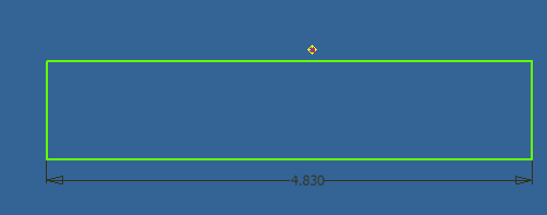

Create a Rectangle and dimension as shown.
If you haven't already, expand the Origin folder at the top of the browser and turn on the Visibility of the Center Point. Let me know if you can't figure out this step.
Here is what I have so far. Not sure about the coincident restraint. I didn't go any further because I wasn't sure if I was going in right direction. Maybe things will clear up a little now. Thanks. I know I have a ways to go here.

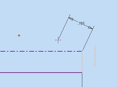

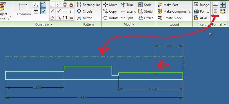

See the attached image. Change the top horizontal line to a center line type (your screen will look different - but the icon is in same general location).
Extend the .765 construction line to the center line.

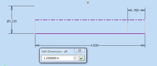

How is it that the rectangle height is an exact number? It should have been random as I didn't instruct to dimension yet.
And in fact when I add the dimension it shows that it is d4. d1 and d2 are missing?
In any case add the diametrial dimension - this is done by selecting the centerline (not the endpoint of the centerline) and second point or line.

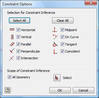

When I drag your sketch point it doesn't stay constrained to the centerline, nor does the vertical line. Show all constraints reveals that there are no coincident constraints on these. Inventor should have automatically added coincident constraints with no input required on your part. In fact, the sketch point isn't even needed.
Just start line command and click on center line and the other horizontal line, then add dimension.
Are you sure you haven't fooled with Constraint Options?
The idea is if I drag that point to the projected origin the entire sketch should move as one and snap to the origin and change color indicating the sketch is fully constrained.

I know what happened now. The way I picked the lines before,
the right vertical line would move in instead of the line I added after adding dimension.
What I did was to create 2 small lines and dimension them, then
move both lines to the endpoint. Then I added the construction
line and deleted the 2 small lines. I still am doing some transition
from Rhino. It's hard, but I'm determined. Once I fully understand
how the constraints work, I'll be better off.
