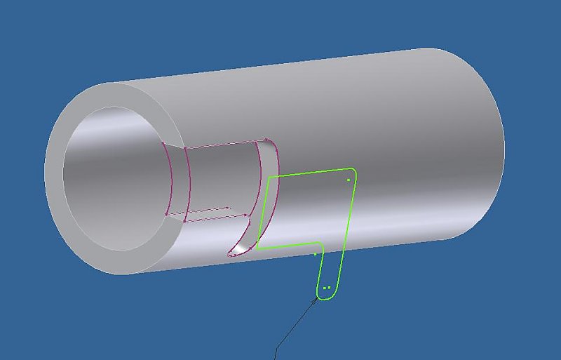

At work i only have IV11 so i cant open your file but the zip did work. Depending on how you want to make this cut there are a few options. if you draw your 2d sketch off the surface, start a 3dsketch and project geometry to the outside face of your tube and the inside face of your tube you can use them for lofting curves. This may be the easiest option. You can also take the projected curves, make a boundary surface and thicken/cut with it. You could also sweep the projected curves if you make a path.
If the image below is what you want you could just extrude the 2d sketch but hopefully the procedure will show you an option. If you can fill me in with a little more detail on what you want to do i may be able to help more.
The mill cut just cuts through the side wall. It is a latch for another piece with 2 ears to lock it in. It basically slides in and then twists to lock. This is close to what I wanted. The slot should be .350 wide on cuts. It is a little wide in the image here. I'm still not 100% sure how you did
this. I had the geometry on a workplane. Is it not possible to project to the surface of 3D model? Your method seems to work, just not real sure how you did it.

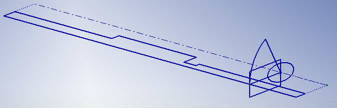

I think maybe you are making this one a bit too difficult. No 3D sketch needed.
BTW the equivalent to SWx method (sort of) would be to do a Sweep Cut with Guide surface.

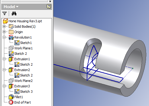

After thinking about it I just realized I could simplify it even further removing the two user workplanes.
Simplified Sketch2
Deleted Workplanes 1 & 2 and Sketch3
60° angle can be set to any desired angle of rotation for the slot.
Extrude pie shape and trimmed lower rectangle midplane width of slot.
Extrude lower trimmed rectangle through all.
Revolve upper angled rectangle.
Add Fillet in lower corner.
Let me know if you can't figure it out and I'll walk you through it step-by-step.

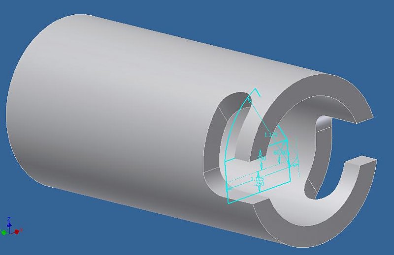

thats kinda what i was thinking jd. I did what you did with a revolve "tube" that extended past the origin point and a sketch on the xz plane in my case. My sketch is a little different than yours.
Harley i drew a rectangle offset from the center point(width of your mill bit) Then i drew a line from the center point up 60degrees and connected the center lines with an arc. Making sure to dimension all your stuff. I did an extrude of the rectangle bi-directionally(1" in my case), then a separate extrude of the triangle back .5". Fillet then do a circular pattern around the Yaxis for the second slot.
