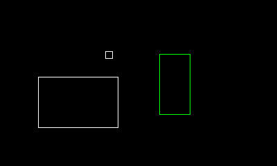

ZZombie Posted June 25, 2009 Author Share Posted June 25, 2009 I'm not too sure how to go about this, but I think it'll involve using dynamic blocks... I would like to have a block with 4 attributes: 1) Name 2)# of instances 3) Width 4) Height. Name and number is determined at the time block is inserted. I would like the block to be able to pull the width/height from a polyline (square) it is assigned to in the drawing. So if the polyline width/height ever change, it will automatically update the blocks attributes for width and height. I already have the block and its attributes setup, i just need to figure out the above. Also, would there be a way for #2 to change the actual count on that name of block? So if i insert it once, and put 3 in # of instances, it'll tell me there are 3 of that block. Anyone have some ideas? Quote Link to comment Share on other sites More sharing options...

ZZombie Posted July 6, 2009 Author Share Posted July 6, 2009 Oh wow, great job there Lee. The att names im using are "NAME", "X-WIDTH", and "Y-HEIGHT" The block name itself could vary in the drawing, I'd be placing multiple blocks for seperate panels actually, so this could create a bit of a problem Unless there is some way of extracting the information through the "Name" attribute. Actually I've just attached a picture to show the info I'd need extracted. Again great job on what you came up with! Quote Link to comment Share on other sites More sharing options...
Lee Mac Posted July 6, 2009 Share Posted July 6, 2009 Ok this should hopefully work. A Few notes: The code uses a reactor that reacts to grip-modifications, but won't work on normal command calls. I tried Object reactors, but had no luck. The Tags are highlighted, alter these if necessary. Type blkupd to invoke the command, click on the block and polyline to link them. Type blkupdshow and hover over various Polylines to show links between blocks and polylines. Any queries, just ask: ;; Block Attribute Updater by Lee McDonnell 06.07.2009 (defun c:blkUpd (/ ins wid hgt bEnt bObj pEnt pObj MiP MaP win num ) (vl-load-com) (setq ins "COUNT") ;; << Instances Tag (setq Wid "X-WIDTH") ;; << Width Tag (setq Hgt "Y-HEIGHT") ;; << Height Tag (if (and (setq bEnt (car (entsel "\nSelect Block: "))) (eq "AcDbBlockReference" (vla-get-ObjectName (setq bObj (vlax-ename->vla-object bEnt)))) (eq (vla-get-HasAttributes bObj) :vlax-true) (setq pEnt (car (entsel "\nSelect Polyline: "))) (wcmatch (cdr (assoc 0 (entget pEnt))) "*POLYLINE")) (progn (vla-getBoundingBox (setq pObj (vlax-ename->vla-object pEnt)) 'MiP 'MaP) (mapcar (function (lambda (Obj) (putxdat Obj "LMACUPD" (vl-prin1-to-string (list (vla-get-Handle pObj) (vla-get-Handle bObj)))))) (list pObj bObj)) (setq win (mapcar 'vlax-safearray->list (list MiP MaP)) num (sslength (ssget "_X" (list (cons 0 "INSERT") (cons 2 (vla-get-Name bObj)) (cons 66 1))))) (foreach Att (vlax-safearray->list (vlax-variant-value (vla-getAttributes bObj))) (cond ((eq ins (vla-get-TagString Att)) (vla-put-TextString Att (rtos num 2 0))) ((eq Wid (vla-get-TagString Att)) (vla-put-TextString Att (rtos (- (caadr win) (caar win)) 2 2))) ((eq Hgt (vla-get-TagString Att)) (vla-put-TextString Att (rtos (- (cadadr win) (cadar win)) 2 2)))))) (princ "\n<< Incorrect Selection >>")) (princ)) (defun c:BlkUpdshow (/ gr ent xtyp xval Objlst) (while (and (setq gr (grread t 13 2)) (eq 5 (car gr))) (if (setq ent (car (nentselp (cadr gr)))) (progn (vla-getXdata (vlax-ename->vla-object ent) "LMACUPD" 'xtyp 'xval) (if (and xtyp xval) (mapcar (function (lambda (x) (redraw x 3))) (setq Objlst (mapcar 'handent (read (vlax-variant-value (cadr (vlax-safearray->list xval))))))))) (if Objlst (mapcar (function (lambda (x) (redraw x 4))) Objlst)))) (princ)) (defun BlkUpdr (Reac Args / ins wid hgt blk ss xtyp xval hand pObj MiP MaP bObj win num) (setq ins "COUNT") ;; << Instances Tag (setq Wid "X-WIDTH") ;; << Width Tag (setq Hgt "Y-HEIGHT") ;; << Height Tag (if (vl-position (car Args) '("GRIP_STRETCH" "GRIP_MOVE" "GRIP_SCALE" "GRIP_ROTATE")) (if (setq ss (cadr (ssgetfirst))) (progn (vla-getXdata (vlax-ename->vla-object (ssname ss 0)) "LMACUPD" 'xtyp 'xval) (if (and xtyp xval) (progn (setq hand (mapcar 'handent (read (vlax-variant-value (cadr (vlax-safearray->list xval)))))) (vla-getBoundingBox (setq pObj (vlax-ename->vla-object (car hand))) 'MiP 'MaP) (setq bObj (vlax-ename->vla-object (cadr hand)) win (mapcar 'vlax-safearray->list (list MiP MaP)) num (sslength (ssget "_X" (list (cons 0 "INSERT") (cons 2 (vla-get-Name bObj)) (cons 66 1))))) (foreach Att (vlax-safearray->list (vlax-variant-value (vla-getAttributes bObj))) (cond ((eq ins (vla-get-TagString Att)) (vla-put-TextString Att (rtos num 2 0))) ((eq Wid (vla-get-TagString Att)) (vla-put-TextString Att (rtos (- (caadr win) (caar win)) 2 2))) ((eq Hgt (vla-get-TagString Att)) (vla-put-TextString Att (rtos (- (cadadr win) (cadar win)) 2 2))))))))))) (defun putxdat (Obj App Data / ent type1 valeur) (setq xtype (vlax-make-variant (vlax-safearray-fill (vlax-make-safearray vlax-vbInteger '(0 . 1)) '(1001 1000)))) (setq xval (vlax-make-variant (vlax-safearray-fill (vlax-make-safearray vlax-vbVariant '(0 . 1)) (list App Data)))) (vla-setXData Obj xtype xval)) (if *lmac-Block* (vlr-remove *lmac-Block*) (setq *lmac-Block* nil)) (setq *lmac-Block* (vlr-command-Reactor nil (list (cons :vlr-CommandEnded 'BlkUpdr)))) Quote Link to comment Share on other sites More sharing options...

Lee Mac Posted July 6, 2009 Share Posted July 6, 2009 Many thanks for the feedback Hopefully this is more reliable: ;; Block Attribute Updater by Lee McDonnell 06.07.2009 (defun c:blkUpd (/ ins wid hgt bEnt bObj pEnt pObj MiP MaP win num ) (vl-load-com) ;;<< Tag Names must be Capitalised! >> (setq ins "COUNT") ;; << Instances Tag (setq Wid "X-WIDTH") ;; << Width Tag (setq Hgt "Y-HEIGHT") ;; << Height Tag (if (and (setq bEnt (car (entsel "\nSelect Block: "))) (eq "AcDbBlockReference" (vla-get-ObjectName (setq bObj (vlax-ename->vla-object bEnt)))) (eq (vla-get-HasAttributes bObj) :vlax-true) (setq pEnt (car (entsel "\nSelect Polyline: "))) (wcmatch (cdr (assoc 0 (entget pEnt))) "*POLYLINE")) (progn (vla-getBoundingBox (setq pObj (vlax-ename->vla-object pEnt)) 'MiP 'MaP) (mapcar (function (lambda (Obj) (putxdat Obj "LMACUPD" (vl-prin1-to-string (list (vla-get-Handle pObj) (vla-get-Handle bObj)))))) (list pObj bObj)) (setq win (mapcar 'vlax-safearray->list (list MiP MaP)) num (sslength (ssget "_X" (list (cons 0 "INSERT") (cons 2 (vla-get-Name bObj)) (cons 66 1))))) (foreach Att (vlax-safearray->list (vlax-variant-value (vla-getAttributes bObj))) (cond ((eq ins (strcase (vla-get-TagString Att))) (vla-put-TextString Att (rtos num 2 0))) ((eq Wid (strcase (vla-get-TagString Att))) (vla-put-TextString Att (rtos (- (caadr win) (caar win)) 2 2))) ((eq Hgt (strcase (vla-get-TagString Att))) (vla-put-TextString Att (rtos (- (cadadr win) (cadar win)) 2 2)))))) (princ "\n<< Incorrect Selection >>")) (princ)) (defun c:BlkUpdshow (/ gr ent xtyp xval Objlst) (while (and (setq gr (grread t 13 2)) (eq 5 (car gr))) (if (setq ent (car (nentselp (cadr gr)))) (progn (vla-getXdata (vlax-ename->vla-object ent) "LMACUPD" 'xtyp 'xval) (if (and xtyp xval) (mapcar (function (lambda (x) (redraw x 3))) (setq Objlst (mapcar 'handent (read (vlax-variant-value (cadr (vlax-safearray->list xval))))))))) (if Objlst (mapcar (function (lambda (x) (redraw x 4))) Objlst)))) (princ)) (defun BlkUpdr (Reac Args / ins wid hgt blk ss xtyp xval hand pObj MiP MaP bObj win num) ;;<< Tag Names must be Capitalised! >> (setq ins "COUNT") ;; << Instances Tag (setq Wid "X-WIDTH") ;; << Width Tag (setq Hgt "Y-HEIGHT") ;; << Height Tag (if (vl-position (car Args) '("GRIP_STRETCH" "GRIP_MOVE" "GRIP_SCALE" "GRIP_ROTATE")) (if (setq ss (cadr (ssgetfirst))) (progn (vla-getXdata (vlax-ename->vla-object (ssname ss 0)) "LMACUPD" 'xtyp 'xval) (if (and xtyp xval) (progn (setq hand (mapcar 'handent (read (vlax-variant-value (cadr (vlax-safearray->list xval)))))) (vla-getBoundingBox (setq pObj (vlax-ename->vla-object (car hand))) 'MiP 'MaP) (setq bObj (vlax-ename->vla-object (cadr hand)) win (mapcar 'vlax-safearray->list (list MiP MaP)) num (sslength (ssget "_X" (list (cons 0 "INSERT") (cons 2 (vla-get-Name bObj)) (cons 66 1))))) (foreach Att (vlax-safearray->list (vlax-variant-value (vla-getAttributes bObj))) (cond ((eq ins (strcase (vla-get-TagString Att))) (vla-put-TextString Att (rtos num 2 0))) ((eq Wid (strcase (vla-get-TagString Att))) (vla-put-TextString Att (rtos (- (caadr win) (caar win)) 2 2))) ((eq Hgt (strcase (vla-get-TagString Att))) (vla-put-TextString Att (rtos (- (cadadr win) (cadar win)) 2 2))))))))))) (defun putxdat (Obj App Data / ent type1 valeur) (setq xtype (vlax-make-variant (vlax-safearray-fill (vlax-make-safearray vlax-vbInteger '(0 . 1)) '(1001 1000)))) (setq xval (vlax-make-variant (vlax-safearray-fill (vlax-make-safearray vlax-vbVariant '(0 . 1)) (list App Data)))) (vla-setXData Obj xtype xval)) (vl-load-com) (if *lmac-Block* (vlr-remove *lmac-Block*) (setq *lmac-Block* nil)) (setq *lmac-Block* (vlr-command-Reactor nil (list (cons :vlr-CommandEnded 'BlkUpdr)))) Quote Link to comment Share on other sites More sharing options...

ZZombie Posted July 6, 2009 Author Share Posted July 6, 2009 It works half the time for me. Some blocks i apply it to, it'll update both of the attributes, and the grip movements update fine. Although other times it wont even give a measurement to one of the attributes. When I load it up though, i received this in the command window. "Command: ; error: no function definition: VLR-COMMAND-REACTOR" Seems that might be a problem? Although interesting how it works half the time User error here... noticed one of my attributes were not named correctly Still thanks a ton! Works great now! One last thing, anyway it could be modified to find the measurement up to 4 decimal places? EDIT: Figured out the the tolerances Is there perhaps a way for it to grab the measurement in fractional form, then convert that measurement into decimal form to become the attribute? I only ask because I ran into a bit of a problem where one dimension will be, for example, 7.8118 (7-13/16") instead of 7.8125 (7-13/16") and the decimal form is what i need [Drawings seem to come out inaccurate sometimes when putting in a fractional measurement, so the odd decimal conversion occurs :/] Quote Link to comment Share on other sites More sharing options...
