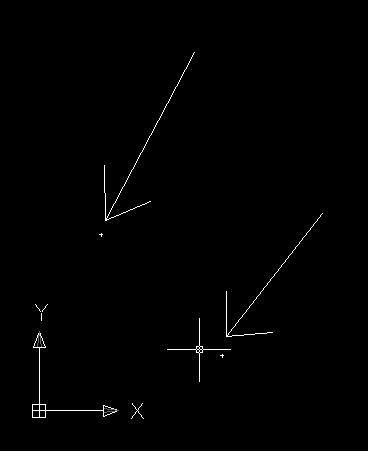

goldy2000 Posted June 25, 2009 Posted June 25, 2009 Hello!! I found some lisp on internet that joins two 3D pline into one, but could it be improved so I can select couple of 3D plines and then join them?? And one more big thing that lisp does to every cad file I open, when selecting something on drawing it leaves small dots on the corner of cursor, but after I zoom or do some other action everything is good, I show it in picture..., I don't know what is it, maybe someone of you had dealing with something similiar problems like this....HOPE THAT THIS IS SOLVABLE because it is very ANNOYING...:shock:, Cheers!!! I only get rid of it reinstalling ACAD... 3PEDIT.LSPFetching info... Quote
ReMark Posted June 25, 2009 Posted June 25, 2009 Those dots represent pick points? Maybe it is your BLIPMODE setting. Quote
The Buzzard Posted June 25, 2009 Posted June 25, 2009 goldy2000 said: Hello!! I found some lisp on internet that joins two 3D pline into one, but could it be improved so I can select couple of 3D plines and then join them?? And one more big thing that lisp does to every cad file I open, when selecting something on drawing it leaves small dots on the corner of cursor, but after I zoom or do some other action everything is good, I show it in picture..., I don't know what is it, maybe someone of you had dealing with something similiar problems like this....HOPE THAT THIS IS SOLVABLE because it is very ANNOYING...:shock:, Cheers!!! I only get rid of it reinstalling ACAD... Sounds like blipmode needs to be set to 0. Quote
goldy2000 Posted June 25, 2009 Author Posted June 25, 2009 ReMark said: Those dots represent pick points? Maybe it is your BLIPMODE setting. Yep, after I select something it shows these little dots, but when does regen or zoom they gone..arrrghhh, very annoying.., did you had something similiar?? I enter it and they GOOONEEEEE!!!!!!!!! THX man, what is exactly BLIPMODE using for??? This is first time to hear for this Quote
The Buzzard Posted June 25, 2009 Posted June 25, 2009 The Buzzard said: Sounds like blipmode needs to be set to 0. Here it is in the main function. I placed a comment. ;..........Main function.................... ;~~~~~~~~~~~~~~~~~~~~~~~~~~~~~~~~~~~~~~~~~~~ ; Global variable = #res (curve resolution) ;~~~~~~~~~~~~~~~~~~~~~~~~~~~~~~~~~~~~~~~~~~~ (defun c:3pedit (/ choice) (initget "C J") (setq choice (getkword "\nChange/Join <J>: ")) (cond ((= choice "C") (change_to_3d)) (T (join3d)) ) [color=red](setvar "blipmode" 1) ;<--- Set blipmode to 0 to get rid of the[/color] [color=red]ticks[/color] (command "ucs" "w") (princ) );end c:3pedit (princ "\n3Pedit.LSP - Ver 1.3 - Compliments of Batson Tool Corp.") (princ "\nUsage -> Command: 3Pedit ") (prin1) Quote
goldy2000 Posted June 25, 2009 Author Posted June 25, 2009 THANKS BUZZARD, you saved me one more reinstalling.. Do you know maybe what is this blipmode using for?? Can this lisp be modified for selecting couple of 3d plines and then join?? maybe someone ask for this in this forum...going to find it..THX MAN one more time.. Quote

ReMark Posted June 25, 2009 Posted June 25, 2009 From the AutoCAD Help file: Blipmode Controls the display of marker blips. When Blip mode is on, a temporary mark in the shape of a plus sign (+) appears where you specify a point. If you issue a Redraw, Regen, Zoom or Pan the blips will disappear. I can't remember the last time I toggled them on. Leave them off...forever. Quote

goldy2000 Posted June 25, 2009 Author Posted June 25, 2009 ReMark said: From the AutoCAD Help file: Blipmode Controls the display of marker blips. When Blip mode is on, a temporary mark in the shape of a plus sign (+) appears where you specify a point. If you issue a Redraw, Regen, Zoom or Pan the blips will disappear. I can't remember the last time I toggled them on. Leave them off...forever. Yep, I also find it after first post, but think that is very ''unusable'' and totally necesarry, because people who don't use ACAD very often don't know why is this happening and search update bugs in Windows or in CAD....THX anywayo:) Quote
