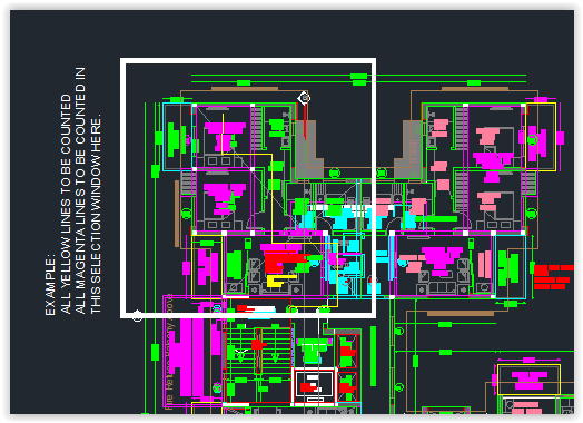

The modification I requested was to use the same filters to choose from, but within a selection set made by a window, instead of digging up the entire database, which may come up with some extra items added.....

As an example, just the total number (for example 10 nos lines) of objects, and sum of lengths of objects (as per the filters provided - layer/linetype/color) within a selection window / crossing required. And similar objects outside the window / crossing ignored. I tried to understand Lee's routine, but couldn't figure out how to modify the Visual lisp. I would request Lee / someone with the requisite knowledge to update when convenient.  And, as an add on, if the filter has  closed polylines, could they be numbered (for example 5 closed polylines) and added too??

Just ONE variation Bigal...... just a window selection from which the same length data is extracted as there is in the existing program..... instead of the entire database.... the rest of the program is great and will be used by me.  Ignore the other area request if necessary.

It may be possible to simply amend Lee's code, BUT I can see that again it will come back with BUT I need this combination also. The only way is to submit the type of combinations you want as I said previously. And make a front end 1st.
This section needs to be rewritten to suit the user request in particular the SSGET filters.

Had a few minutes, Multi toggles.lsp is in Downloads. For anyone thinking about this. Multi toggle Image in other post.
Just did some simple testing not extensive.
; Multi total length choice with a user choice dcl for filtering
; By Alan H info@lanh.com.au June 2020
; Thank you to Lee-mac for the original Tlen code
; changed to just accept a given selection set
(defun AH:tlen (s / e i l s )
             (setq l 0.0)
            (repeat (setq i (sslength s))
                (setq e (ssname s (setq i (1- i)))
                      l (+ l (vlax-curve-getdistatparam e (vlax-curve-getendparam e)))
            (alert (strcat "\nTotal Length: " (rtos l 2 2)))
(defun c:multi-sel ( / lst1 ans str lst1 x ss filter)
(if (not AH:Toggs)(load "Multiple toggles.lsp"))
(setq ans (reverse (ah:toggs   '("Please choose" "Arc" "Line" "Plines" "Circle" "Layer" "Color" "Linetype"))))
(setq lst1 '())
(if (= (nth 0 ans) "1")(setq lst1 (cons "Arc" lst1)))
(if (= (nth 1 ans) "1")(setq lst1 (cons "Line" lst1)))
(if (= (nth 2 ans) "1")(setq lst1 (cons "*Polyline" lst1)))
(if (= (nth 3 ans) "1")(setq lst1 (cons "Circle" lst1)))
(setq str "")
(repeat (- (setq x (length lst1)) 1)
(setq str (strcat str (nth (setq x (- x 1)) lst1) ","))
(setq filter '())
(setq filter (list (cons 0 (strcat str (nth 0 lst1)))))
(if (= (nth 4 ans) "1")(Alert "this is not done yet \n \n will pop a list box"))
; probably do an option pick layer objects or list
(if (= (nth 5 ans) "1")(setq filter (cons  (cons 62 (getint "enter Color number")) filter)))
(if (= (nth 6 ans) "1")(Alert "this is not done yet \n \n will pop a list box"))
(setq ss (ssget filter))
(if (/= ss nil)
(aH:tlen ss)
(alert "No objects match")
