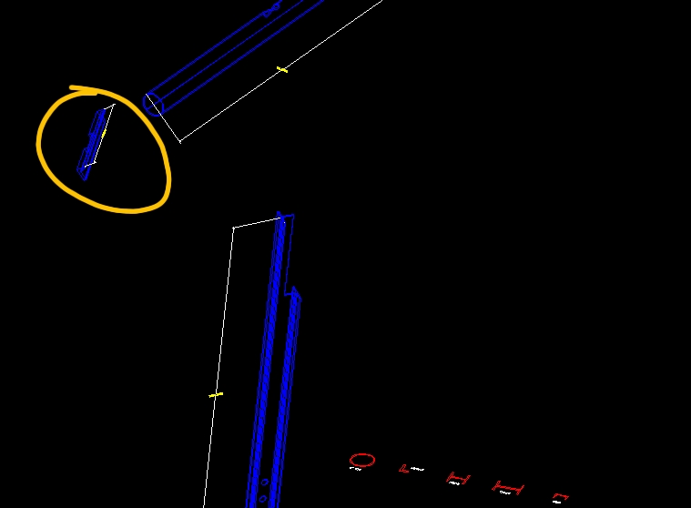

SEANT Posted January 3, 2010 Share Posted January 3, 2010 I find the Oriented Bounding Box (OBB) problem quite compelling. It has such widespread applicability that it justifies all the thought it can be given. It also seems to be the type of programming problem that could hinge on the perfect algorithm. I’m not sure, however, if even that would be 100% bulletproof (I think that is why MickD prefers the “data imbued at creation” methodology). Perhaps the biggest problem associated with a commercial OBB offering, then, would be determining at what point is the routine considered successful for any given industry. For my BOM requirements, for instance, the correct dims returned from the part illustrated in post #40 would be nice, though not absolutely necessary. It may even be more helpful for me if that solid were just flagged as indeterminate; it has other factors to consider beyond its length in I-beam. Those realities aside; programmers indulging their intellectual curiosity tend not to be satisfied with semi successful algorithms. Quote Link to comment Share on other sites More sharing options...
SEANT Posted January 3, 2010 Share Posted January 3, 2010 Luis, that routine is working pretty well . . . . even with solids that are more complex than I would typically be concerned about. It is, however, tripping up one of the solids in the file I attached to post #15 of this thread. It’s interesting because that solid is not particularly complex. Perhaps therein lays a clue as to the type of algorithm you are using. Quote Link to comment Share on other sites More sharing options...

LEsq Posted January 3, 2010 Share Posted January 3, 2010 Hi Sean, I'll have a look. OK, on a quick look, it appears the issue are the points, if you move that solid to the origin 0,0,0 from any of the bottom base points, you will see that it will output the right data. Since I am just working with points, it is interesting to see, as to why fails if those points are not way to far from the origin, this appears to be an issue with autocad coordinates precision, and something I suffer when wrote my gbpoly program for example - or it can be seen if one use bpoly function with very large coordinates. Will try to fix that - and also the box temp vectors, this needs more work for sure. Quote Link to comment Share on other sites More sharing options...

LEsq Posted January 3, 2010 Share Posted January 3, 2010 Luis, that routine is working pretty well . . . . even with solids that are more complex than I would typically be concerned about. It is, however, tripping up one of the solids in the file I attached to post #15 of this thread. Sean, I was able to did a quick fix and now appears to work for this case in particular - there is now an updated zip uploaded. Still it might fail with other solids - also there is some more work to do on this project. LE! Quote Link to comment Share on other sites More sharing options...
