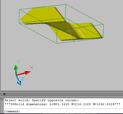

LEsq Posted January 3, 2010 Posted January 3, 2010 OK, was just able to play with this old project, let see if someone will be willing to give it a try - it is an ARX file for AutoCAD 2007 to 2009 only. The command name is OBB. This OBB algorithm: Does not change or align anything it simple will try to calculate the oriented bounding box and return the dimensions. Notes: 1. OBB.ARX it is provided AS-IS - use it at your own risk! 2. Run the testing on not working drawings! 3. Or make sure to save a backup first! 4. It is a debug version and not fully tested. 5. This version - does not work on a Cylinder. 6. Expect crashes. Load the attached arx file and once the command it is called just select a 3D solid - and if it is successful it will print on the command the dimensions. Command: OBB Select solid: Specify opposite corner: ***3DSolid dimensions: L=1739.7404 W=1198.0539 H=1198.0539*** Comments are welcome. Thank you for your trust, Luis. Obb.zip Quote
LEsq Posted January 3, 2010 Posted January 3, 2010 Did some update to the project and added a feature to show the oriented bounding box (using graphic vectors - see the attached image). Still sphere, cones, and cylinders are not supported and all the previous notes applies too. LE! Quote
