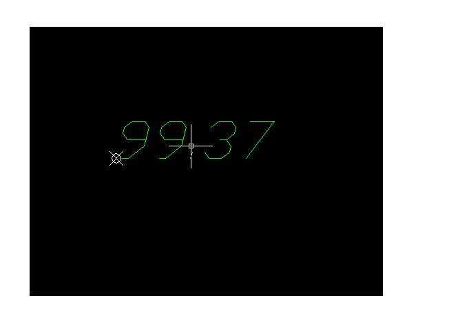

Hello to the best CAD FORUM in this part of internet:D...I have a question, is it possible to make a lisp that can export value of Z coordinate to a new layer (called VISINA_TEXT)?? I have 3D point and I need to export (allocate) value of Z coord in the text file(but two digits only after comma: 99,37 in this case) which is situated like it is in the example file?? 8)

Hy man!! I mean to assign (cannot find appropriate word for that) text that will contain Z coord.
Example: I have 3D point with coord (X,Y,Z --> 65,24,22.33), so I need to extract Z coord (in this case 22.33) to be written in text 22.33 (but in some new layer), the problem is to ''read'' Z coord and ''write'' in text form...was this helpful??:huh:
