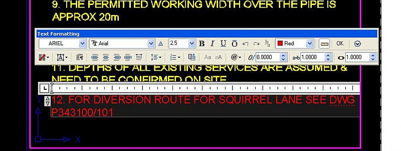

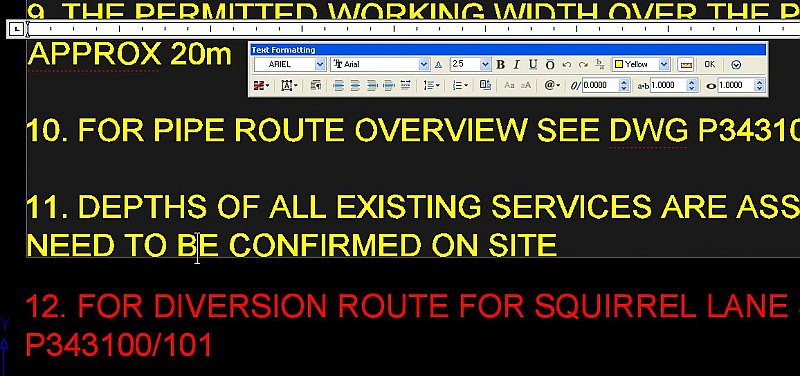

spittle Posted June 17, 2009 Share Posted June 17, 2009 For some reason the yellow text appears slightly bolder than the red text. These need to be separate pieces of text. If I match properties from one to the next, the problem is still there. They both use the same text style are identical as far as I can see. I've tried resetting the Z coordinate in properties already. Any ideas? Quote Link to comment Share on other sites More sharing options...
NBC Posted June 17, 2009 Share Posted June 17, 2009 Looks like it may have some form of elevation (z value) assigned to it. To remove it, select your text, type CHANGE, then P, then E, then 0. Quote Link to comment Share on other sites More sharing options...
spittle Posted June 17, 2009 Author Share Posted June 17, 2009 Tried that already without success. I'm wondering if it's been drawn on a plane that isn't parrallel to the XY plane, though I'd expect that to make the text narrower, not bolder. Quote Link to comment Share on other sites More sharing options...
StevenMc Posted June 17, 2009 Share Posted June 17, 2009 is it because of your pen settings? in my office yellow plots at 0.25mm and red at 0.1mm Quote Link to comment Share on other sites More sharing options...
spittle Posted June 17, 2009 Author Share Posted June 17, 2009 It's not driven by plot style as it's Arial font, it prints the same whether it's yellow or red. Quote Link to comment Share on other sites More sharing options...
Danse_Macabre Posted June 17, 2009 Share Posted June 17, 2009 It's not driven by plot style as it's Arial font, it prints the same whether it's yellow or red. Really? I had no idea you could by-pass the plot style depending on which type of text you used. I thought that plot styles were driven by differing colours only. Quote Link to comment Share on other sites More sharing options...
spittle Posted June 17, 2009 Author Share Posted June 17, 2009 Yeah some are shape files and are controlled like any other line and have a file extension .shx. then you get TrueType (TT) fonts that are normal fonts and plotsyle is irrelevant. Quote Link to comment Share on other sites More sharing options...
Strix Posted June 17, 2009 Share Posted June 17, 2009 ... and at the risk of being really obvious, you have checked that it isn't just 'bold' then? Quote Link to comment Share on other sites More sharing options...
spittle Posted June 17, 2009 Author Share Posted June 17, 2009 Yes - and even using match properties from one bit of text to the other doesn't fix this. Quote Link to comment Share on other sites More sharing options...
chelsea1307 Posted June 17, 2009 Share Posted June 17, 2009 is there a reason for using two different mtext boxes? why not just use one (the one plotting right) and change the color of the text thats supposed to be red? Quote Link to comment Share on other sites More sharing options...
spittle Posted June 17, 2009 Author Share Posted June 17, 2009 The yellow text is common to 16 sheets and is in model space, shows on each title block via a viewport, the red text is in paper space in just one sheet and is red just so I can quickly see it's different. (The problem occurs though whether I'm in model or paper space) Quote Link to comment Share on other sites More sharing options...
