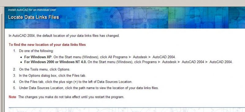

Ok swaroop,
I took another look and what I think you are referring to is the built-in data link manager in AutoCAD itself. There is no special software required. I do not think this is a very easy way to go as far as what the other person is looking to do. This is a bit more involved. The other person is looking for a program to accomplish this.
Here is what I found on the subject.
Autodesk tip: http://usa.autodesk.com/adsk/servlet/ps/dl/item?linkID=9240615&id=11752914&siteID=123112
Here is a link on the subject from The CAD Geek: http://thecadgeek.com/blog/2007/04/linking-excel-and-autocad-with-data-links/
From AutoCAD Help file:
