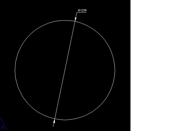

nicnicman Posted March 24, 2008 Posted March 24, 2008 Hello all, I am pretty new to AutoCAD and I have a question about diameter dimensions. When I dimension diameters all I get is a leader line and the diameter. I would like to get a complete dimension line with two arrows and the measurement. Attached is what I would like the dimension to look like. By the way I got this image from another post in this forum it is not my own. Any help would be greatly appreciated. Quote

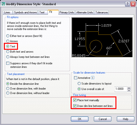

Cad64 Posted March 24, 2008 Posted March 24, 2008 Make sure you have "Draw dim line between ext lines" checked in your Dimstyle. See below: Quote

nicnicman Posted March 24, 2008 Author Posted March 24, 2008 I just noticed that it works when I place the text outside of the circle but when I move the text inside the circle it changes to a single leader line. It would be great if I could have the dimension inside the circle and complete dimension line. Sorry the picture I attached was misleading. Quote
Cad64 Posted March 24, 2008 Posted March 24, 2008 Ok, you had me scratching my head there for a second. I didn't realize you were trying to get the dimension on the inside. See below: Edit: If you check all 3 of the boxes shown below, you will have the freedom to place your dimension inside or outside the circle and you will always have your leader lines displayed as you want them. Quote

Cad64 Posted March 24, 2008 Posted March 24, 2008 That's a bad habit to get into. There is no reason to ever explode dimensions. If you set up your Dimstyle the way I showed in my previous post, you will be able to dimension circles exactly the way you were asking. Quote

nicnicman Posted March 25, 2008 Author Posted March 25, 2008 Thanks for all the responses. Cad64 your suggestion worked perfectly. Too bad I didn't see it before I exploded the dimension. The think the reason I didn't see your suggestion is that I had the forum open for a while and responded before hitting the reload button on my browser. Woops! Anyways thanks a lot and I will definitely remember this in the future. Quote
