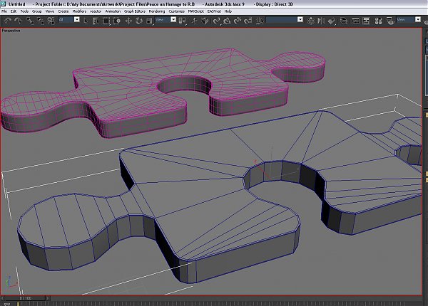

matramurena Posted March 20, 2008 Posted March 20, 2008 Hi, I made a drawing in Acad, it is a piece from a puzzle, with a round bit on one end flat surfaces. When I import this into 3DS Max, I get facettes when I render it. I can't seem te get the puzzle-piece look better without distorting the flatness of the front and back side... Any suggestions? Please? Quote
matramurena Posted March 27, 2008 Author Posted March 27, 2008 I tried it, but it doesn't seem to get rid of the facettes I have in the picture. When I render the piece in Acad it looks great with facetres at 10. When I render it in Max it looks faceted.... Any other suggestions? Quote
matramurena Posted March 30, 2008 Author Posted March 30, 2008 Yes I tries Turbosmooth as well. The problem is that it deforms the whole object when I do that. It's about the same when you have a cylinder with just 8 sides. Then I have to get this looking round again without simply setting it to more sides and without the flatness of the top and botom to be affected..... I can't seem to do that... Quote

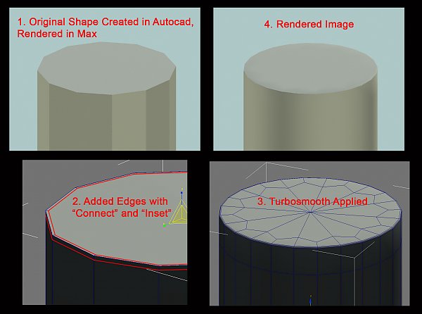

Cad64 Posted March 30, 2008 Posted March 30, 2008 In order to use the Turbosmooth modifier effectively, you must first add some extra edges to your object. This will force Turbosmooth to respect your sharp corners Quote

hendie Posted March 31, 2008 Posted March 31, 2008 looks like you may have to edit each vertex manually, or even add some more Quote
Cad64 Posted March 31, 2008 Posted March 31, 2008 As Hendie suggested, you just need to add more geometry for Turbosmooth to work with. Take a look at what I did below: Quote

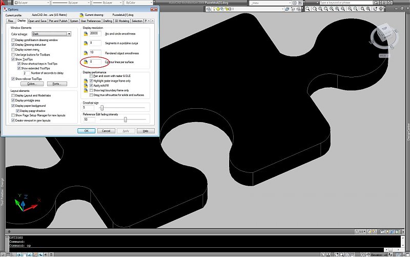

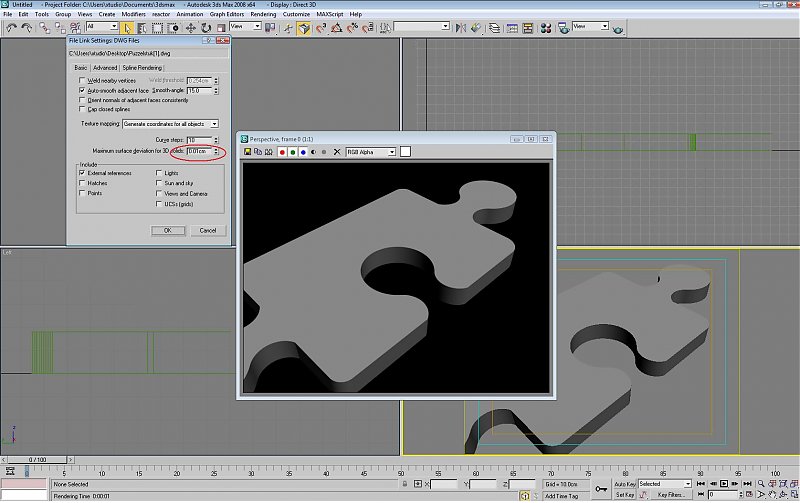

xtudio Posted July 21, 2008 Posted July 21, 2008 Hi, it may be a little to late, but about the facetres problem when importing a .dwg file to Max, you have to modify some settings to resolve this problem. First in AutoCAD, on Options --> Display, you must set the Contour lines per surface to 0, and in Max on the Link manager --> Maximum surface deviation for 3D solids to 0,01 Hope to be useful in the future Quote
corrosive Posted June 18, 2010 Posted June 18, 2010 matramurena said: Hi, I made a drawing in Acad, it is a piece from a puzzle, with a round bit on one end flat surfaces. When I import this into 3DS Max, I get facettes when I render it. I can't seem te get the puzzle-piece look better without distorting the flatness of the front and back side... Any suggestions? Please? your solution can be found in a dialog box that will appear when you import your autocad file. Quote
