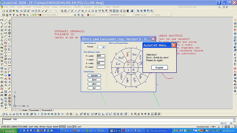

Hi the buzzard
When do a calc with WATS and Volts I got this error.
With the first formula selected you need to supply values in E and R.
You put values in E & P, So you will get a divide by zero error.
When ever you select a formula, You need to supply the two value you
have selected in their proper boxes.
