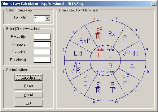

Hello to All,
I finally finished this Ohm's Law Calculator and I seem to be pleased with the results, However the program size has me bothered. When using vector image on more complex entities such as circles and text, It creates much larger than expected lists. I tried to duplicate the image with MSLIDE, But I have no control over the image size that way and cannot duplicate the same results as vector image.
Anyway, I am posting it just the same for feed back.

Woww... haven't tried the code just yet, but just looking at the LISP: So Many Numbers....you sure do love your vector images.
If the posted pic is anything to go by, then superb work Buzzard :D
Lee

Thank you Lee,
I do like the fact that I do not have to deal with slides when it comes to vector image. The size of the program without using it is next to nothing as compared to putting the image in. Just does not seem worth it. MSLIDE is a real pain in another sense.
Anyway the program works well.
Your DCL is a thing of beauty!:)
I would approach the lisp & vector coding a bit differently, but it gets the job done.
Thanks CAB,
What would you suggest in terms of a different approach?
For the vectors I would separate the circle/background into one list and make each cell
into separate list. In this way you can feed the list to the vector_image with each group
and just change the color for the group you want to use red on.
For the operation of the user entry I would have a CLEAR button that blanked all 4 edit boxes.
Then the action would react to the ENTER key. If there was only one value entered, do nothing.
If there were two values entered & would solve for the two missing values.
That's just my approach. Nothing wrong with yours.
PS You could turn two formula red to match the results.
I think I know what you mean. I would have to mess with it a bit to get the feel for it, But that make so much sense.
I will give that a shot and see what happens.
Thanks for the advise.

CAB,
I did a test using the wheel with the text as the base image. Then I use only the selected red text for each selected image as the conditionals and seems to work well. I just need to finish it off. Will post the new version over the weekend.
With regard to the program operation, I would need to study that much further.
Great Tip on the images, That will reduce the program size dramatically.
Thanks again,
The Buzzard

Attention to All,
CAB introduced to me a fix for the vector image eliminating the image redundancy and thus producing a much smaller program.
The programs original size was 582KB reduced down to 119KB.
What a major difference that is.
The revised files have been uploaded to the first post, So you can get the program there.
Thank You CAB and to All Enjoy!

Very nice Buzzard, just been playing around with it :D
I love that dialog image, superb illustration - and many thanks for the mention in the "About" dialog - I feel honoured :D
1 thing you might want to consider though, perhaps include a line of code to account for divide by zero errors with perhaps an error tile to notify the user if they enter, for example, 0 Ohms in formula 1.
Just a thought :)

Thanks Lee,
I thought about something like that which is why if you notice I have the program default to 1's. It will still not prevent the user from entering arbitrary values though. An error alert would be good for that reason. I was also thinking about having the program put in the other two values as CAB had mentioned, But I would need to toy around with that.
By the way did you download the latest fix? I had reduced the program size by adjusting the vector image so it works the same way without all the redundancy of the same image in each frame. The program came down from 582KB to 119KB from that fix alone.
I will be trying a few things with it over the weekend to see how much better I can improve it. The only reason I took this one on was that there were no threads in this forum with regard to the subject. As far as I know this is the only Ohm's Law Calculator on CADTutor. I just figured it would be worth while since it was not too involved to make.
Anyway I will work on the fix you mentioned over the weekend. I want to take a break from Lisp for a few hours.

Hey, no rush mate - just a minor thing.
Yes, I used the latest fix - much neater in its condensed form. :thumbsup:
Perhaps you don't need that much elaborate coding to check for things like that, just a "vl-catch-all-apply" check would be sufficient if you didn't want to check for zeros where they shouldn't be.

Not sure as how to use that since I have not taken the time to learn VL.
I am sure I can go a different way to get a good result.
Thanks for the feedback.

    (set_tile "ANS" (strcat "Voltage = " E " volt(s)"))                 ;Set tile ANS, Concatenate string, evaluate E
   ((vl-position SFN '("10" "11" "12")) ; another way to test
    (setq R (RTOS R 2 1))                                               ;Set R ~ (Resistance), Return to string, Decimal, 1 zero
    (set_tile "ANS" (strcat "Resistance = " R " ohm(s)"))               ;Set tile ANS, Concatenate string, evaluate R
And yet another method.
(defun OLC_DCO (/ lst data)
 (setq lst '(("Power = " P " watt(s)")
             ("Current = " I " amp(s)")
             ("Voltage = " E " volt(s)")
             ("Resistance = " R " ohm(s)")))
 (setq data (nth (fix(/ (1- (atoi SNF)) 3)) lst))
 (set (cadr data) (rtos (eval id) 2 1))
 (set_tile "ANS" (strcat (car data)(eval id)(caddr data)))
Note the switching values in a variable like 'R' from a string to a real and back to a string is bad practice
and very confusing during debugging & updating a routine. I did not change that in my examples though.
Also global variables is bad as well. Not always avoidable but you should try to localise them.
That's all for tonight. PS not tested!
Off for some tennis....:)
Thanks Again For The Help CAB.
But I thought I did localize all the variables?
;;; F02 - Main Function - Main Dialog Page.                                    ;Describe function
(defun OLC_MDP (/ P I E R IMG SFN KV1 KV2 KV3 KV4 w h)                         ;Define function, Declare local variables
CAB
I understand what you mean now. I should keep the variables localized to their respected functions. Got it.
I will look over everything again and fix accordingly.
Thanks
