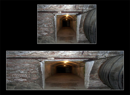

Cad64 Posted March 20, 2008 Posted March 20, 2008 Here you go. Both images are inserted as blocks. The top image has not been adjusted. The bottom image has been given an X scale factor of 2.0 Quote
Nephilim Posted February 16, 2016 Posted February 16, 2016 cad64, can you make a video on how you did it.. thanks in advance Quote

Cad64 Posted February 16, 2016 Posted February 16, 2016 cad64, can you make a video on how you did it.. thanks in advance Wow! This is an old thread. It's pretty simple to do. If you know how to insert an image, create a block and open your Properties palette, you should be able to do this with no trouble at all. Quote
Cad64 Posted February 16, 2016 Posted February 16, 2016 cad64, can you make a video on how you did it.. Ok, since I need some practice using my screen recording software, I made a video: Quote
