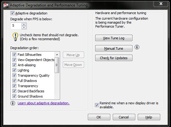

DanSandy Posted August 30, 2011 Posted August 30, 2011 Finally found a solution to this!!!! In AutoCAD on the command line type: 3DCONFIG Click on "Check for updates"... allow it to update all those drivers... Then make sure you are using the most current video driver for your video card. Stop pulling out your hair and get working!!! Hope that helps! `Dan Quote
