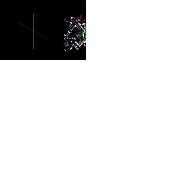

OK. I have a drawing I received but the crosshairs are at a strange angle. I have tried world, plan etc but nothing seem to get them back to normal. Any suggestions?

Quickly tap F5, if the orientation changes then the icon is set in isometric mode.
I f this is the case, right click OSNAP and select settings, click on snap and grid tab, select rectangular snap.
Another way would be Tools>Draughting Settings>Snap and Grid

Thank you very much!!!
