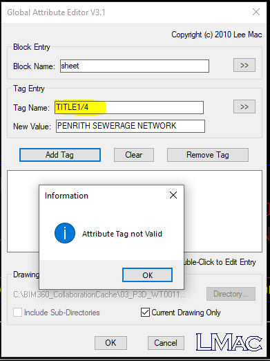

nolex Posted April 28, 2022 Share Posted April 28, 2022 (edited) On 6/12/2009 at 1:03 AM, Lee Mac said: This program will allow the user to extract all attributes from multiple blocks in multiple drawings, and will write all data to an Excel spreadsheet. The user is prompted to create a list of block names from which attributes will be extracted. The user is then prompted to select a directory of drawing files to process, and also provided with the option to process sub-directories of the selected directory. Results will then be written to an Excel Spreadsheet, to be saved as the user wishes. Among many other uses, this program may be used to create a Drawing List, by inputting the name of the titleblock, and the attributes that you want to extract from it, and setting the mode to 'Drawing List Mode' (within the 'Options' Dialog), so that the data is grouped in one list. (See the Header for more info). Your feedback, comments and suggestions are welcome Lee Preview: Attribute Extractor: http://www.theswamp.org/screens/leemac/MacAtt%20V2.6.png http://www.theswamp.org/screens/leemac/MacAttTagOrder.png Options Dialog: http://www.theswamp.org/screens/leemac/OptionsV2-8.png Attribute Editor: http://www.theswamp.org/screens/leemac/Prev.png Function Syntax: MacAttEdit / MacAttExt / MacAtt Code available here. Hi Lee, This is quite a powerful routine. But when I used it on a Tag Name with a / symbol, it's saying "atttribute tag not valid" error. Any fix would be highly appreciated. Thanks Edited April 28, 2022 by nolex Quote Link to comment Share on other sites More sharing options...
mhupp Posted April 28, 2022 Share Posted April 28, 2022 That tag name looks ganky. should it be TITLE3/4 ? its not the / thats causing the error but the two " either side of it. Quote Link to comment Share on other sites More sharing options...
nolex Posted April 28, 2022 Share Posted April 28, 2022 3 hours ago, mhupp said: That tag name looks ganky. should it be TITLE3/4 ? its not the / thats causing the error but the two " either side of it. oh yes you're right, it's TITLE3/4. Sorry I tried to put some quote in there hoping it would work but didn't realise it was captured along. did you have some fix for me though? Quote Link to comment Share on other sites More sharing options...
nolex Posted April 28, 2022 Share Posted April 28, 2022 4 hours ago, mhupp said: That tag name looks ganky. should it be TITLE3/4 ? its not the / thats causing the error but the two " either side of it. actually the error is caused by the /. The 2 quotes are me trying to figure out what works, just some trial and error I did but to no avail. Quote Link to comment Share on other sites More sharing options...
mhupp Posted April 28, 2022 Share Posted April 28, 2022 TRY TITLE3//4 Quote Link to comment Share on other sites More sharing options...
nolex Posted April 28, 2022 Share Posted April 28, 2022 12 hours ago, mhupp said: TRY TITLE3//4 still not working. Quote Link to comment Share on other sites More sharing options...
Lee Mac Posted May 2, 2022 Author Share Posted May 2, 2022 On 4/28/2022 at 3:34 AM, nolex said: This is quite a powerful routine. But when I used it on a Tag Name with a / symbol, it's saying "atttribute tag not valid" error. Any fix would be highly appreciated. I'm pleased that you find this old application useful; though, you may find my more recently developed Batch Attribute Editor application a more powerful attribute editing utility, given that it offers the ability to edit attribute values across multiple blocks of varying block names. You may argue that the use of a Script file to perform the attribute modification across multiple drawings is inherently less powerful than the ObjectDBX interface leveraged by this older program, however, ObjectDBX has too many bugs where attribute modification is concerned and so I have since abandoned it's use for this purpose. Nevertheless, to allow the user to specify tags containing slashes (and other such characters), change the following lines: Line 1265 from: ( (or (not (snvalid str)) (vl-string-position 32 str)) To: ( (vl-string-position 32 str) Line 1457 from: ( (or (not (snvalid str)) (vl-string-position 32 str)) To: ( (vl-string-position 32 str) Line 1579 from: ( (or (not (snvalid new_tag)) (vl-string-position 32 new_tag)) To: ( (vl-string-position 32 new_tag) Line 2485 from: ( (or (not (snvalid tag_str)) (vl-string-position 32 tag_str)) To: ( (vl-string-position 32 tag_str) 3 Quote Link to comment Share on other sites More sharing options...
