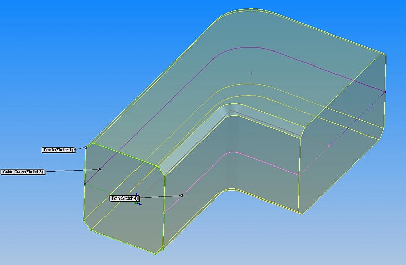

rymanvw Posted June 11, 2009 Posted June 11, 2009 Hi, I am trying to make a tunnel using the sweep command and I am not sure how to go about doing it. I have some guide curves and a sweep path and profile but the path wont sweep Sldwrks says it has self intersecting geometry. I think I am doing my guide curves wrong. Thanks in advance. Quote

shift1313 Posted June 11, 2009 Posted June 11, 2009 put a fillet on your centerline path and try again using only the centerline. The self intersecting error is because of that sharp corner. It doesnt like that as a path. Quote

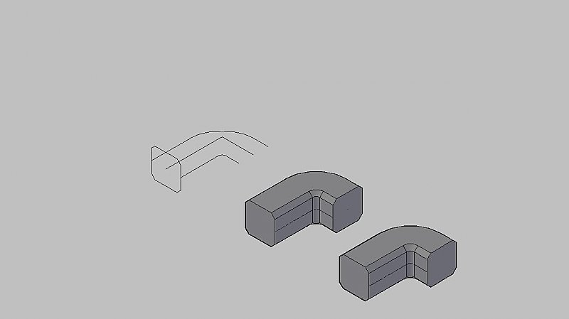

ReMark Posted June 11, 2009 Posted June 11, 2009 My tunnel sweep in AutoCAD. Middle image was swept using the outside path. Right image was swept using the inside path. Doesn't seem to be much difference. Quote

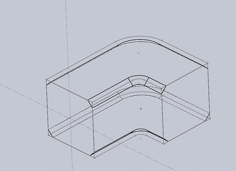

shift1313 Posted June 11, 2009 Posted June 11, 2009 you can select the outside, or you can select a centerline and guides. The issue comes when you try to distort your sketch. The standard selection is to sweep a single path. For sweep to work with those guide curves i believe you would need to take the inner radius and do an offset curve out to your outter edge. You could create your tunnel at the end of your curves and loft that with no issues. If i get a second i will try to recreate that. Quote

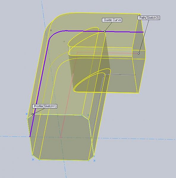

shift1313 Posted June 11, 2009 Posted June 11, 2009 Here is a screen shot of whats happening. you can play around with the different normal settings and different guide curves. That screen shot is with the path and one guide curve. When i try to use both it fails. The closest i could get was using the loft command. If you sweep just using the center path you can go back and fillet the edges but this may not be the result you are looking for. Quote
rymanvw Posted June 11, 2009 Author Posted June 11, 2009 the edges are not just a simple fillet. It is a more complex curve. I was getting the same results as shift when I tried using one guide. Shift did the loft work or no luck? Quote

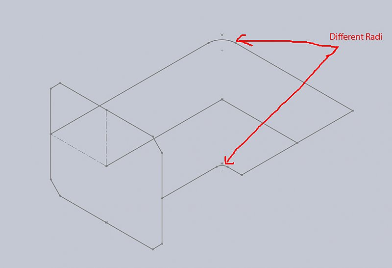

rymanvw Posted June 11, 2009 Author Posted June 11, 2009 It looks a little like a parabola it is not extremely complex, but it is not as simple as a fillet. Quote

shift1313 Posted June 11, 2009 Posted June 11, 2009 yes you can open a dwg right in SW no problems. I did have luck with the loft but i only used two guides, you really need more than that. I would loft it with 4 guides(just a rectangle) then chamfer the edges after the loft. What are the specs at the corners? or maybe some rough numbers to work off? Quote

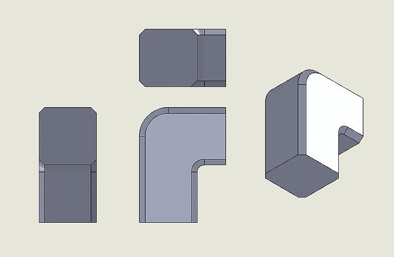

shift1313 Posted June 11, 2009 Posted June 11, 2009 here is one i just did using loft and 4 guide curves then chamfer after. Quote

shift1313 Posted June 11, 2009 Posted June 11, 2009 I would have to disagree. I think SW will give you an accurate result, there are just more options that you have to play with to get exactly what you want. I think the loft will give you the most accurate because you are able to define all 4 corners(or 8 if you want the chamfer the corners pre-loft) Quote
jaims Posted June 18, 2009 Posted June 18, 2009 I'm not sure I fully understand the constraints on your design, but as ReMark suggested you can easily use a sweep defined by the outer sketches, rather than the centreline sketch. You'll need to ensure that the construction lines you show aren't constrained as both VERTICAL and MIDPOINT, otherwise the swept profile won't be able to 'stretch' around the curves as the length of the rectangle changes (obviously the vertical edges stay the same length, but the horizontal lines will be all over the shop! Use Pierce constraints where possible, perhaps adding points to the swept profile. Have I missed something in the design? Quote
