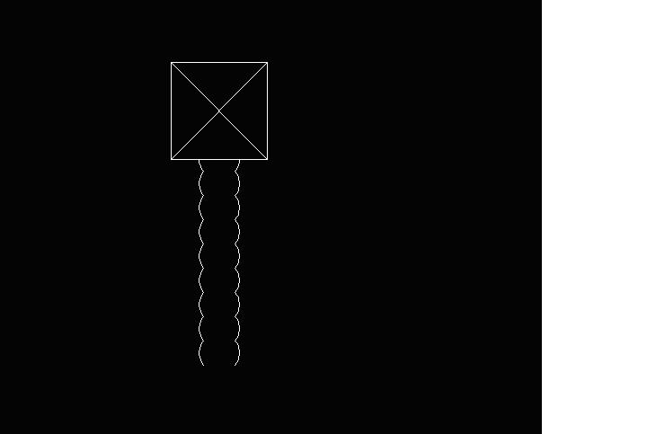

Ive found many lisps for these on various sites but not that fit our offices standards and the way they like it to look(yes they are picky) Now that im trying to learn lisp i figured id take a stab at getting one that they will use.

That is what i have so far. I have var. C for the endpoint of the polyline/line that will be the start point for the flex duct. after creating the first circle on the endpoint I want to copy the circle from the center a distance of A+1 along the polyline/line selected I have no idea how to do this. any help in the right direction would be great (again im trying to write this not wanting someone to write it for me) also open to suggestions on another way to go about it attached is an image of what i want the final to look like
You got a really tough one there.
You can use MEASURE to copy circles. Trimming by offsetting the path PLINE might be a solution but it would be tricky. -David
yea, after your responses i might hold off on this one a bit until i get a little farther into it
One answer is in polylines you can create a polyline with multiple arcs along it. I cut this out of another program so not tested but it is set to draw 90mm arcs.

Ok second go the lisp code cut from has 5 different patterns

Thanks Big Al ill take a look at these and see if i can figure out whats going on and how to modify to my needs
