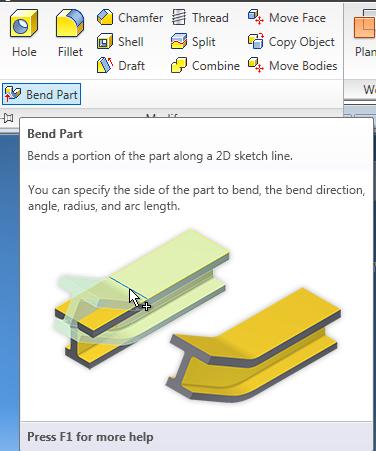

How about if you want to bend a 3d object. I know this is prob. far fetched but I figured I would ask. I would like to see fi there is a way to bend and existing 3D solid.

Upgrade to AutoCAD Inventor.

There is no Bend Part tool in AutoCAD. Of course it might be possible to model the part "as bent", but that was not the question. The question was if it is possible to bend a solid already created. The short answer is no, the solution is upgrade (or model as bent).
If I couldn't cover the $1300 price difference between vanilla AutoCAD and AutoCAD Inventor in a very short period of time (in the mechanical field) I would change careers.
The short answer is no, I agree. However, depending on what the solid in question is, there might be workarounds in AutoCAD that can be used to achieve a bent result. To get a definite answer, post up a new thread with the actual solid and we'll see if someone knows a trick to do it.
