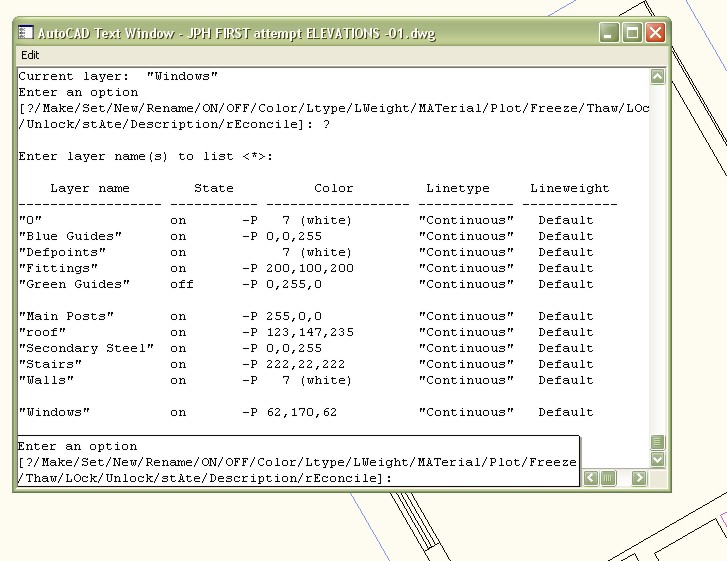

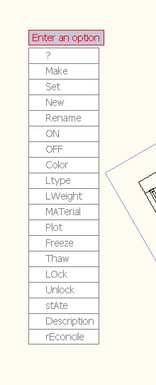

Back in April I posted a question that did not elicit any replies. I still have the problem so here goes again… I hope this time someone can assist.
I appear to have set something by accident and can't find a way of getting the function back.
According to the help files and “AutoCAD for Dummies” When I click on the Layer Properties button in the Layers section of the ribbon, I would expect to get this…
I can get the Layer Properties Manager by using the CLASICLAYER command.
However the layers palette does not appear. Instead if I click in the main drawing area I get this…
If I then choose the "?" option and press enter I get this…
It looks like a macro programme listing in the AutoCAD text window.
What must I do to get the Layers Palette to appear when I press the Layer Properties button?

Check your CMDDIA variable. Make sure it's set to 1.

The CMDDIA value was set to 1
I tried "0" as well - either way it made no difference.

What happens when you type LA or LAYER at the command line. Does this open the layer manager?
Nothing - see earlier posts although typing CLASICLAYER will not work now but it used to. I still get the list of options and the macro listing.

When I type LA or layers it does not open Layer Properies Manager. No matter what I do I can not get the Layer Manager to open.
I didn't know CLASSICLAYER was a command.
Is it the same as the LAYERDLGMODE variable? Try setting that to 0, perhaps that might kick some sense into it.
The new floating layer palette introduced in 2009 was and remains a slow and buggy piece of work in 2010, so I keep it on the classic setting instead. I haven't experienced problems this severe though.

Under Vista, click on Control Panel, Uninstall a program, it gives you the option of repairing an install. That worked for me, otherwise would need to re-register the program with Acad.
After reinstalling the program, type CUI in the command line, it will list the "Workspaces".

I had an issue with the Layer Properties Manager always having to be closed before I could continue working on a drawing. Changing the variable in LAYERDLGMODE cured that problem. I am sure glad I found this post. I was getting tired of have to do that all the time. I have two screens so it is nice to be able to keep that window open.
