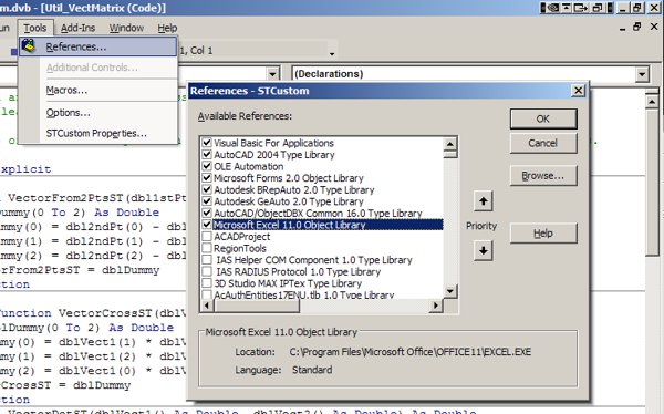

tells me it can't find project or library as well :(
One of the reason this will happen is if the project (.dvb) references a version of Excel different from what is on the current machine. From within the VBAIDE, look if anything is listed as "Missing" in References. If it is Excel, select the correct version (may have to scroll down to locate it) for the machine.
these are whats missing:
AEC MEP 5.5 Application Library
AEC MEP 5.5 Base Object Library
AEC MEP Plumbing 5.5 Base Object Library
Apparently this VBA project is very AEC MEP specific. If you are trying to use it with Standard AutoCAD 2007, the project will likely need modification to avoid tripping up on those missing libraries.

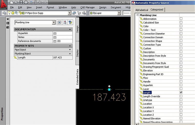

I created a Duct Material Schedule that calculates sheet metal area, weight, liner area, lengths, etc. - it was done with the use of Property Set Definitions. You could accomplish the same thing for Piping.
-Buzz
Plumbing ducts do have parameters like length, dia meters etc, but plumbing lines do not, can you please check it, if there is any option?
Piping objects do have Length, plumbing lines do too, but you have to add them to the Property Set Definitions...
-Buzz
You are genius, the information you have provided me really worked... thank you
but can you tell me the next procedure to create schedule for plumbing lines as its not available in the Shedule and Tag option for plumbing. please your quick reply is needed
