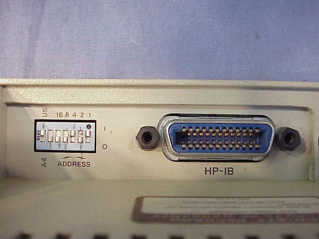

Jack_O'neill Posted June 7, 2009 Posted June 7, 2009 Hi Jack, Thank you for the info on the USB serial adapter. I was wondering, would you happen to know if HP's HB-IB interface will accept a standard RS-232 serial port connector? I've attached an image of an HB-IB port on an HP7470A 2-pen plotter. Do you think I would need a special HP cable for this type of plotter? Thanks again! According to the document I found below, that interface requires an HP cable. Standard RS232 is listed as "option 1" and the HP-IB interface is "option 2". The part number for the cable is listed in the document. Look on page two, down near the bottom. http://www.buy17.com/HP/pdf/hp7475a.pdf Here's another you might look at too: http://www.hpmuseum.net/display_item.php?hw=73 Quote
kindergartenchats Posted June 7, 2009 Author Posted June 7, 2009 According to the document I found below' date=' that interface requires an HP cable. Standard RS232 is listed as "option 1" and the HP-IB interface is "option 2". The part number for the cable is listed in the document. Look on page two, down near the bottom.[/quote'] Hi Jack, This is super helpful thank you. Do I have this right then - the HP7470A 2-pen plotter pictured above was ordered as an Option 2 plotter using a proprietary HP-IB cable vs Option 1 (an RS-232 cable)? I'm guessing that it would be better to find a plotter that uses a universal serial cable. Does this make sense? Would you have any recommendations for 11x17 pen plotters that might be an easier go to install (if I can't find an HP 'Option 1' plotter)? Many thanks! Quote
Jack_O'neill Posted June 7, 2009 Posted June 7, 2009 Hi Jack, This is super helpful thank you. Do I have this right then - the HP7470A 2-pen plotter pictured above was ordered as an Option 2 plotter using a proprietary HP-IB cable vs Option 1 (an RS-232 cable)? I'm guessing that it would be better to find a plotter that uses a universal serial cable. Does this make sense? Would you have any recommendations for 11x17 pen plotters that might be an easier go to install (if I can't find an HP 'Option 1' plotter)? Many thanks! Yes, you're right. I don't know much about the small plotters, the only ones I've ever worked with would do E-size sheets. Ioline, Mutoh, Calcomp, etc... There is an HP 7475A six pen plotter on Ebay right now though. Says it has the RS232 interface. Quote
