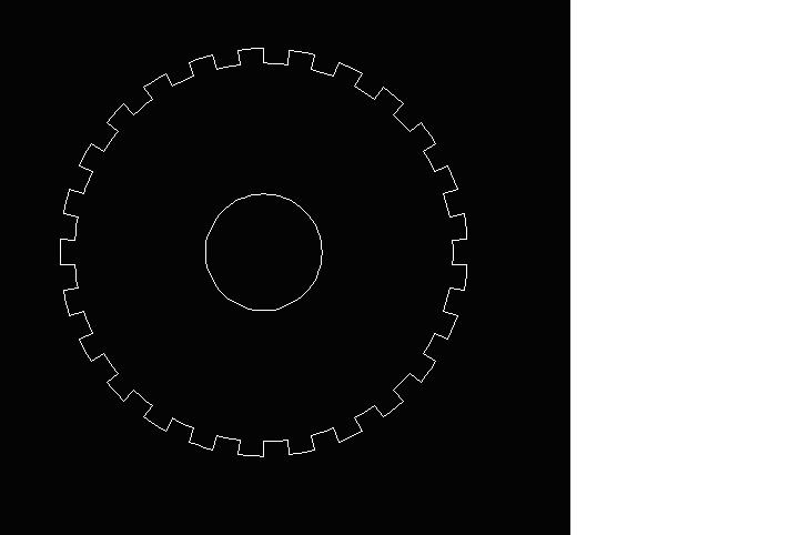

I just tried real quick, its took three circles, the array command and trim.
1st create your inner circle then offset it to the distance you want to the inner part of the grear teeth, then offset that to the distance you want the outer set of the teeth
2nd draw a line from a quadrant on the outermost circle to the equivilant qadrant on the middle circle
3rd start you array. select polar array select the line you just drew as your object, select 360 as your angle to fill select the center point of your circle, and choose a number for total number of items (double the amount of teeth you need if you know or divide the circumfrence by how wide the teeth need to be)
select preview if it looks like a bunch of lines going between your outermost circle and your middle circle your on the right track
4th start the trim command and select all the lines (not the circles - i did this by selecting everything including the circles then unselecting the circles) press enter, now on your outermost circle start selecting every other section of circle between the lines, after your finished do the same to the inner circle but on the opposite lines, below is an image of what i got
