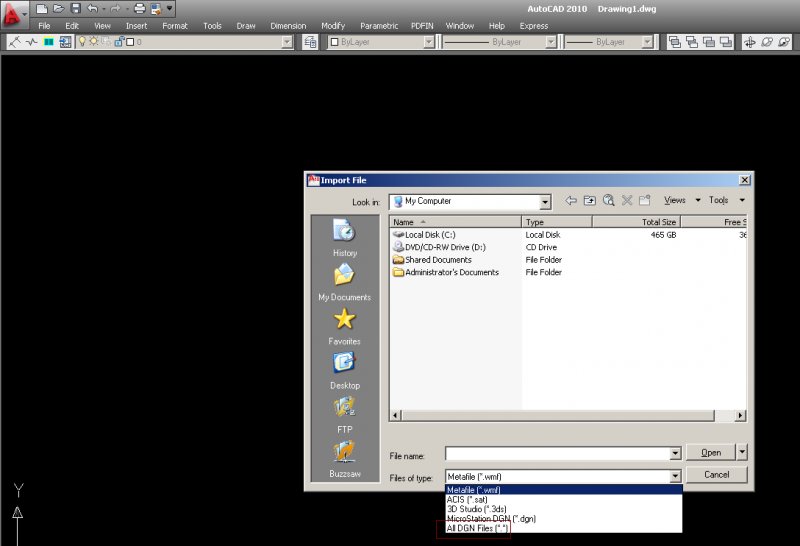

Jack_O'neill Posted January 23, 2012 Share Posted January 23, 2012 You can import a DGN file in 2010. Go to the file menu, down to import, then in the "files of type" change it to "all DGN files". See pic below: Quote Link to comment Share on other sites More sharing options...
Jack_O'neill Posted January 23, 2012 Share Posted January 23, 2012 Excerpt from the help files follows: You can import MicroStation® DGN drawing files into DWG files. The import process translates basic DGN data into the corresponding DWG file data. There are several translation options to determine how certain data such as text elements and external references are handled. Users can not only manipulate text elements and xrefs, but also select the conversion units based on DGN unit settings, and most importantly, preview the default mapping translation or create and use their own mapping setups (see DGNMAPPING). Exchanging and reusing basic drawing data is useful in collaborative projects. For example, service organizations such as AEC and design-build firms might need to import mapping data created with MicroStation into a site plan created with an AutoCAD-based product. The DGN data can serve as an accurate reference for creating the site plan. NoteDGNIMPORT is not limited to files with *.dgn extensions. It supports all DGN files, even those that do not have a .dgn extension. Quote Link to comment Share on other sites More sharing options...
